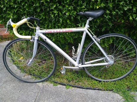

I just finished re-assembling the SR500 and adjusting the derailleurs. Now for the test ride in 90 degree and muggy weather. The handlebars have not been re-taped yet, but I can't wait to fall off this good looking thing. I'm going for a short ride! LOL
wild
I'm going to give it a run this morning before the heat gets all the way up. Yesterday was just a short ride around the block to make sure the wheels didn't fall off. The bike is very quick in regard to handling, something that I'm not. LOL

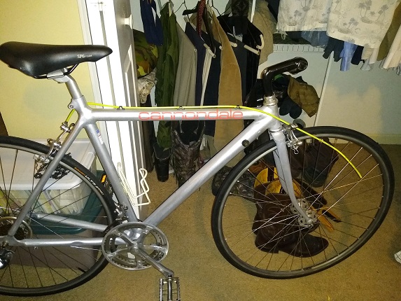

I've decided to convert this bike to a flat bar road bike largely because of my age and the leaning forward thing. I had hoped to have the finished bike pictures up, but the 3" rise handle bar from Spain has been held up in Orlando. I hope the guy didn't try to sneak anything over in them. I did find a set of Shimano SIS MB shifters for cheap and a very inexpensive set of Promax MB/RB brake levers. I also found a vintage Sakae 42-52 crank set with a chain guard that works pretty well. Hopefully, there will be some more pictures next week.
Sounds like everything should work. Did you check to be sure bar clamp diameter of the new bar is the same as your stem? Guessing you might need to snag a couple of MTB brake cables, but I don't know those levers.
wild
I haven't bought the cables or the down tube cable guides yet. The Shimano levers look like they just duplicate the movement of the old levers except on the bar. I went with simple click levers over the ones on my MB, although I like the way they operate. The old handlebar diameter is 25.4mm so I'm sticking with that. If the 3" rise is too much, I'll swap out for the straight bar on my beater bike.

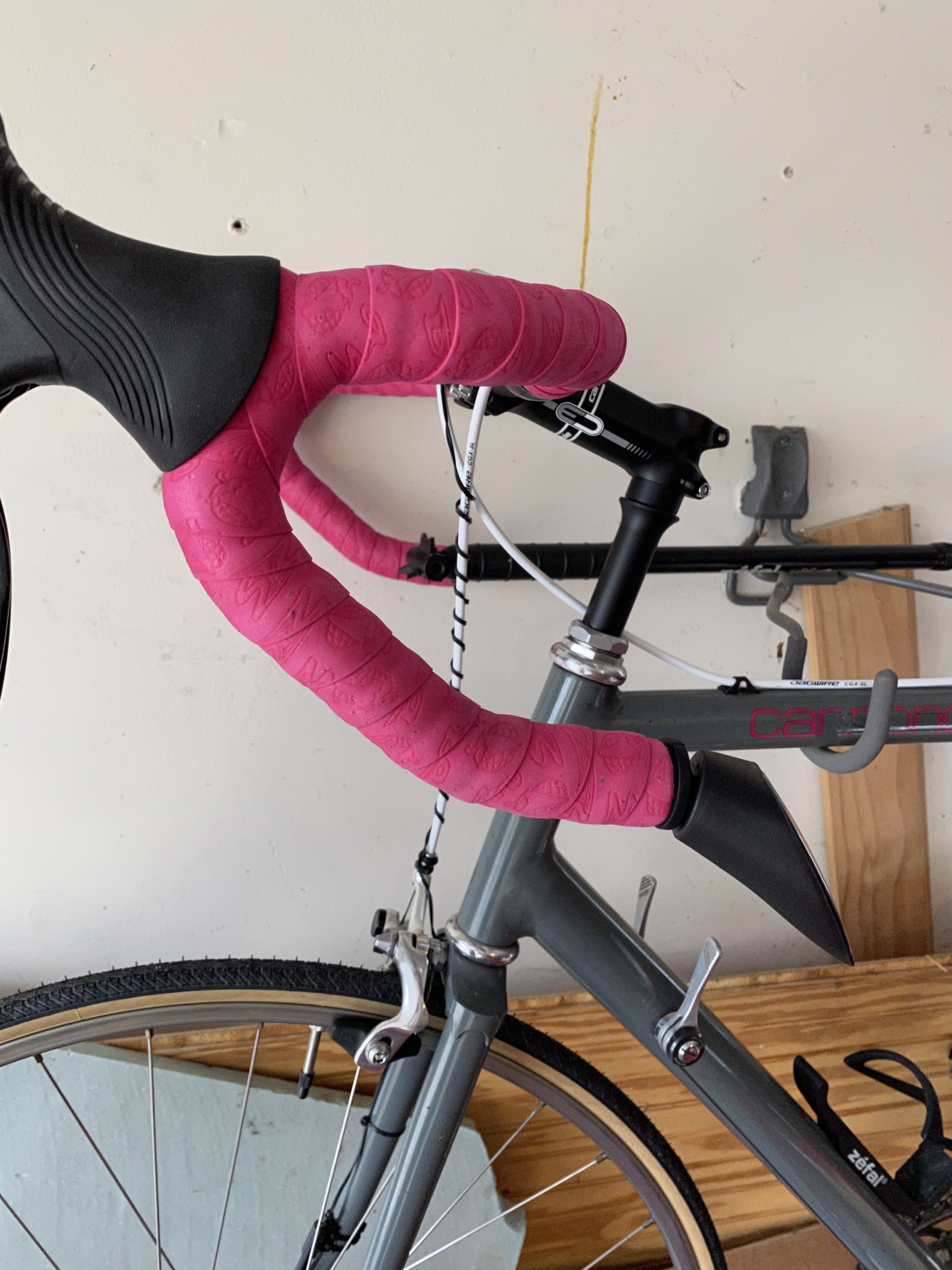

SR400 -105
This looks great. I have an 87 SR400 which I purchased in 1988. 105 groupset, 600 ultegra headset is the exception. The cranks I think are suntour (the whole bike should have been this as I now understand). In riding the bike many years as I aged I found it was more and more uncomfortable. What changed this for me was a modern saddle, a modern stem, better bars (wider for my shoulders) and modern brake levels that were not designed for cables coming out of them like the shimano of the day. The drop and shape of the bars provides much better flat surface that the modern brake hoods extend. I know it is not vintage this way but it is sooo much better in practical use. The longer the ride the more you appreciate the upgrades. Before you tape up it is just a suggestion if your goal is to ride it a lot.
