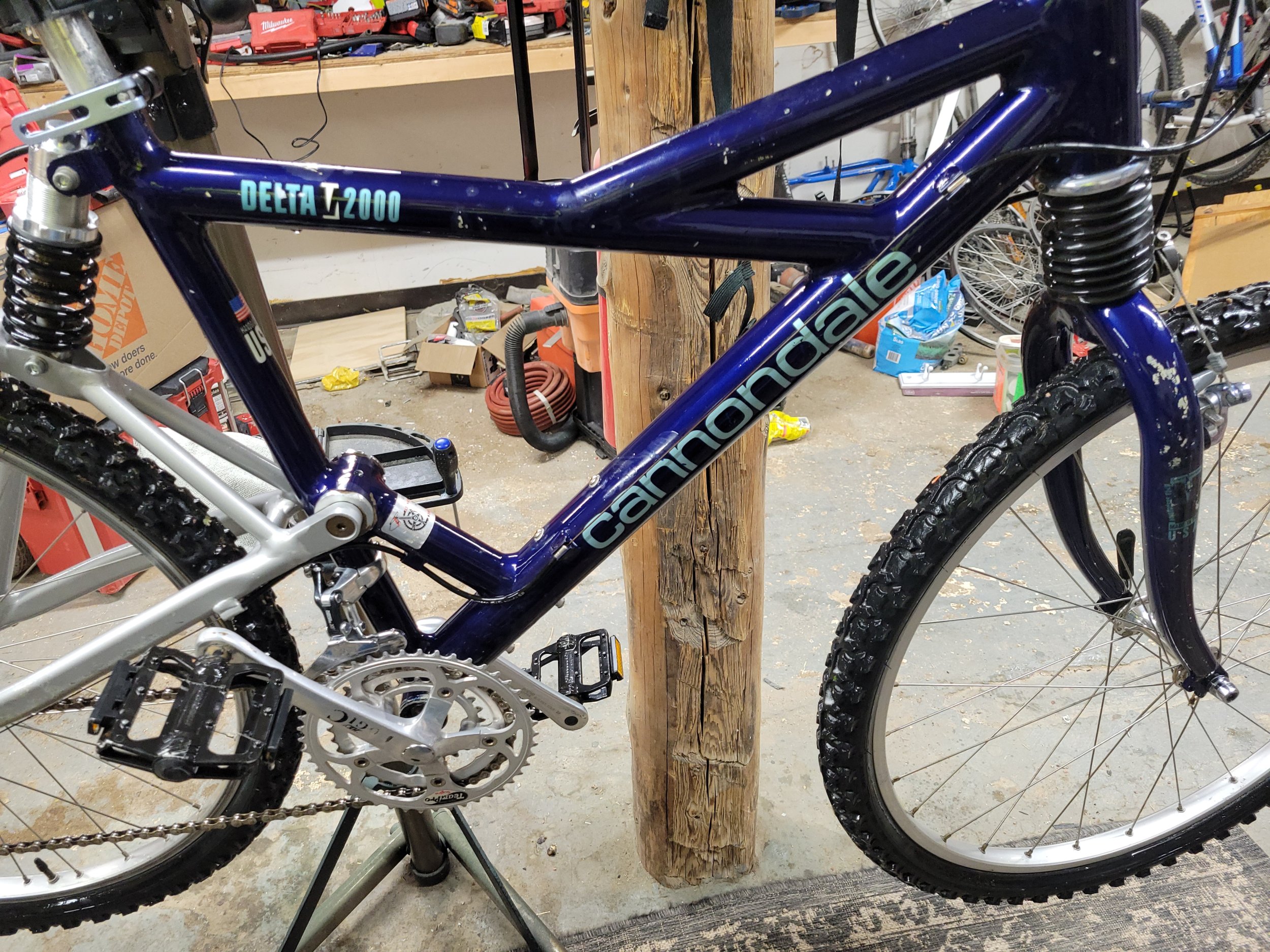

1993? Delta V 2000... cant find serial number
Gaugepro
Checked the bottom of the bottom bracket, nothing. I have the original owners manual with what I think is the serial number but for a 1993 it doesn't match the sequence it should be. It closely matches the "92" style ones.
Anyone have thoughts?

I can see where you might be confused by location of the serial number. It's quite common to see early production bikes with serial numbers in a different location when the location changes. Like it did between 1992 and 1993. Your serial number will be on the inside of the chainstay or seat stay. The format is the same that was used for the version 2 of the 1986-1992 models. It can be a bit hard to see the serial number through the paint covering it, depends on how hard it was stamped into the metal really.
The color way is dead on for a 1993 Delta V 2000.

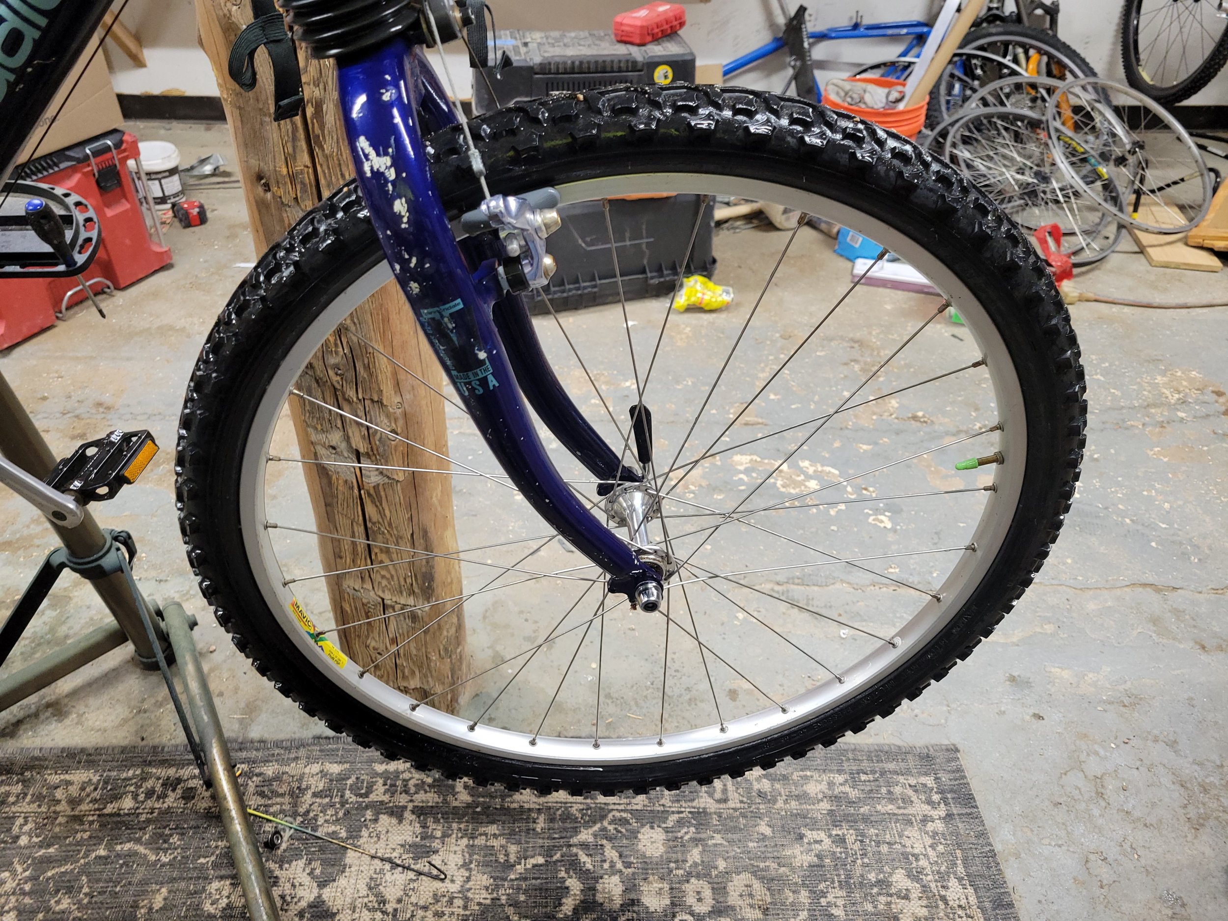

Well I talked to Craig about the front fork and it's not serviceable, I'll need to swap to something else or hope I stumble across one that works still.
Lots of forks out there but wanted to stay with the bent style so it looks more original.
I've seen one or two pop up on E-bay from time to time.
