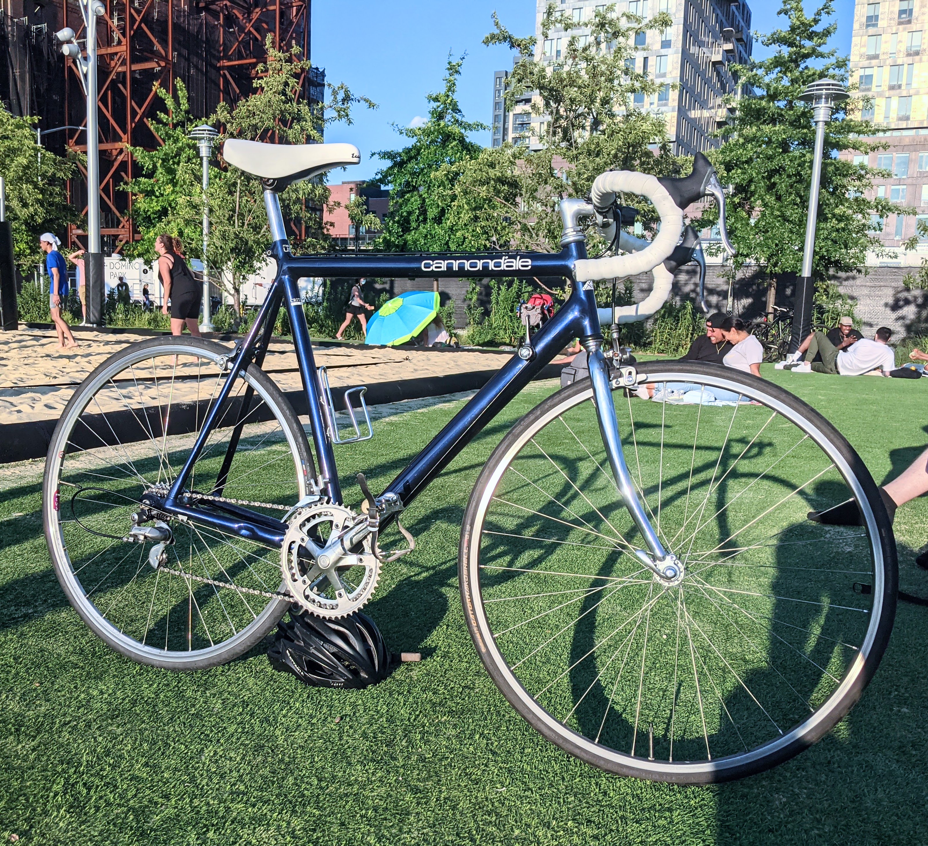

1989 SR800 rebuild
Bought this SR800 frame on craigslist (no fork unfortunately) and built up with Shimano Tri-Color components. Arcane Moto in Brooklyn did an amazing job with the new powder-coating and I'm absolutely in love with it. Rides smooth, light, and quick. Tell me what you think!

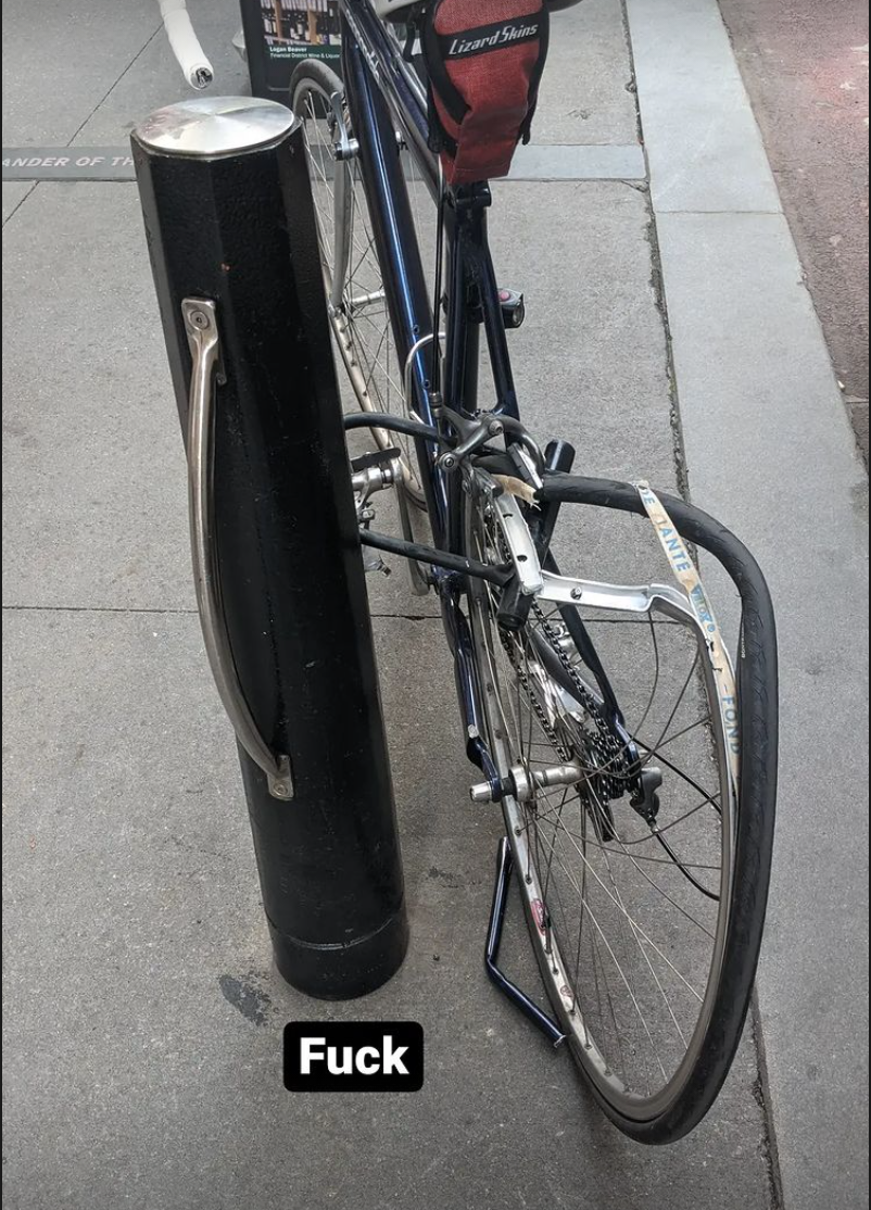

Very unfortunate update: truck hit my bike and snapped the frame while it was parked.

That's a shame. Hope that you will be compensated.

Sorry to hear that some idiot hit your bike. I'm glad you weren't on the bike when it was hit! Hopefully, you'll find a great deal on a replacement from the same era.
