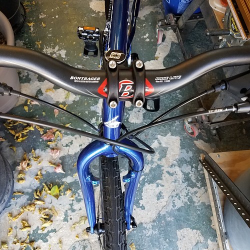

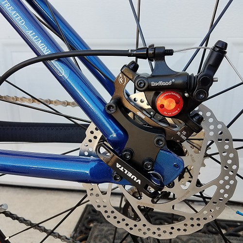

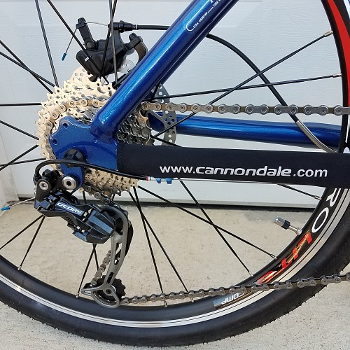

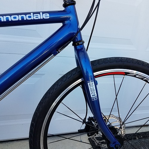

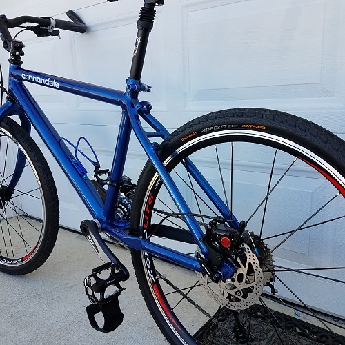

Rescued this 1988 Alpine 3.0 frame from the local landfill. While it had some of the original components, I decided to go with a complete rebuild with a few mods. The frame was completely stripped to bare metal when I picked it up, so I started with the blue metallic paint.

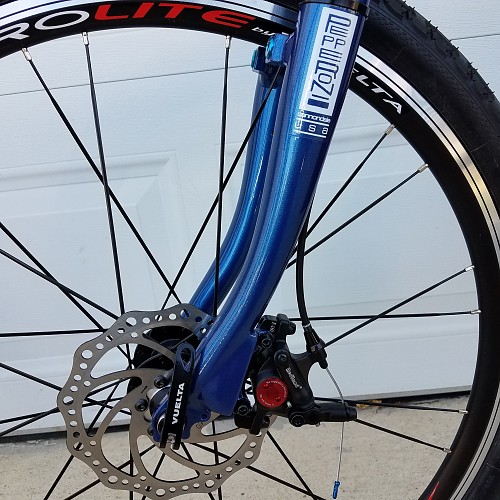

The Pepperoni fork was a later version that had the 1-1/8" steerer. A machinist helped with the modification to replace the steerer with a high strength 1" tube and added the disc brake mount. A bolt on adapter was...
