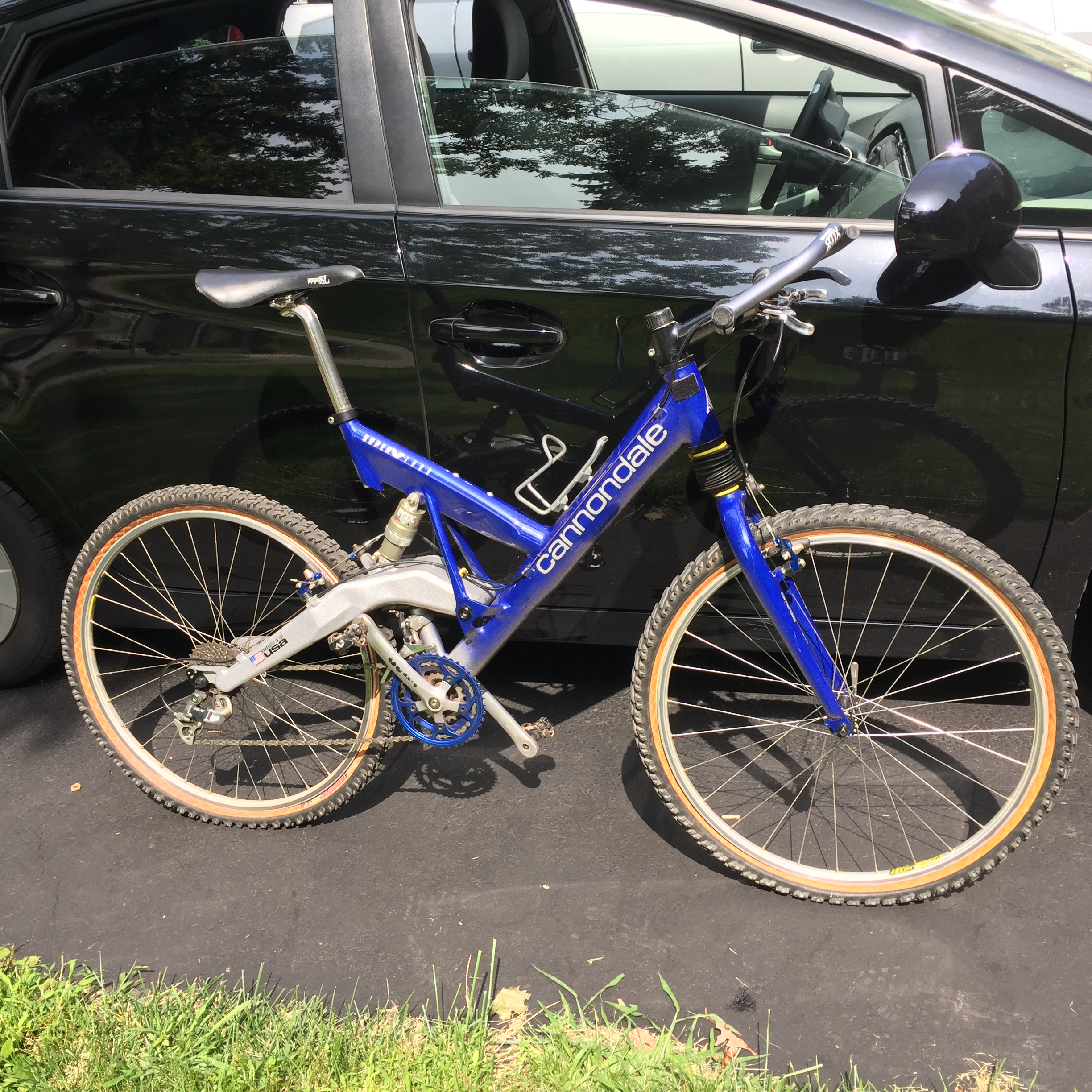

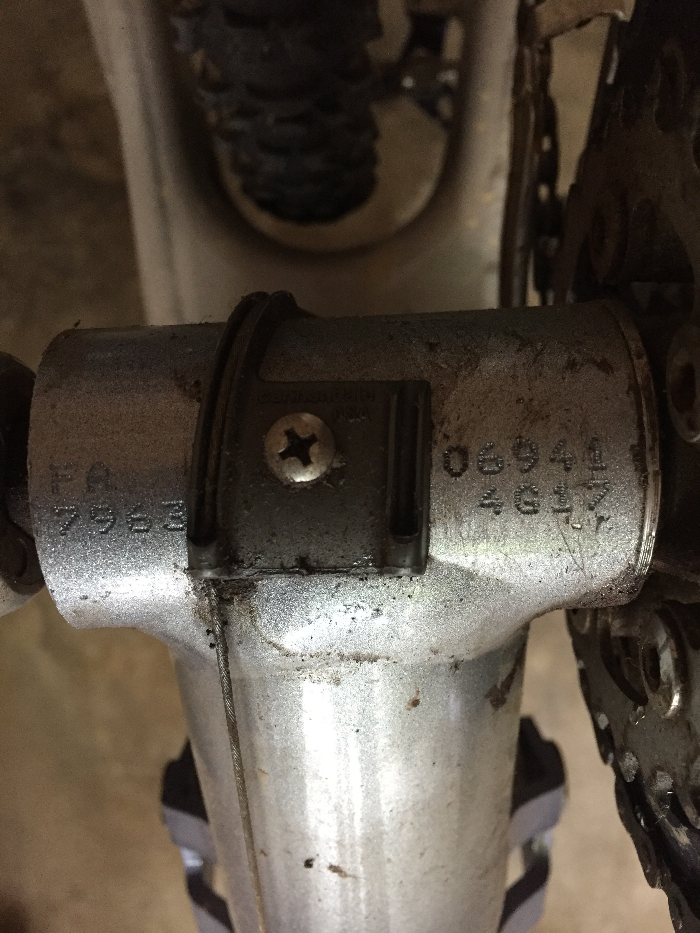

Hi All, was wondering if anyone could help identify what size this Cannondale is? I am unable to tell by the serial number. It's a 1994 Super V 1000. Thanks!

Unfortunately this information is not known, the old Cannondale had this info.. :(
Easiest way to size the unconventional frames is by wheelbase. The Super Vs only came in size 17", 19", and 21". Wheelbase was 109.09 cm, 111.63 cm and 114.17 cm respectively. Have someone hold the fork straight while you measure from axle center to axle center. Even better would be to have a third person to take a measurement from the other side of the bike at the same time and average the two. That would eliminate error due to steering angle.
