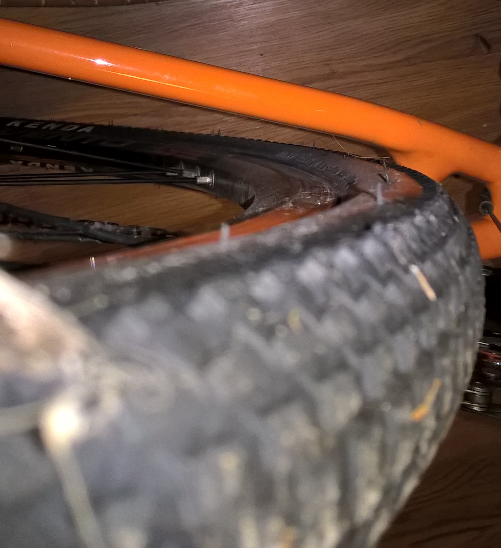

I checked my 1999 XR800 which has Campagnolo Vento wheels and 35 mm Kenda Small Block Eight tires. The tires measure about 33 mm and there is 5-6 mm clearance at the chainstays. My advise would be to stick to 35mm tires for these frames unless you know for a fact that the tire you are interested in tends to mount up a bit narrower than the nominal width. I'd guess that a Kenda 38 would clear (in dry conditions) but I wouldn't want to guess about Schwalbe, never having used them.
How is the clearance in front compared to rear? On the aluminum fork models you could probably fit a bigger tire on the front than on the rear. That is also true with my 2010 CAAD8 CX (carbon fork) but I haven't owned one of similar vintage to yours.

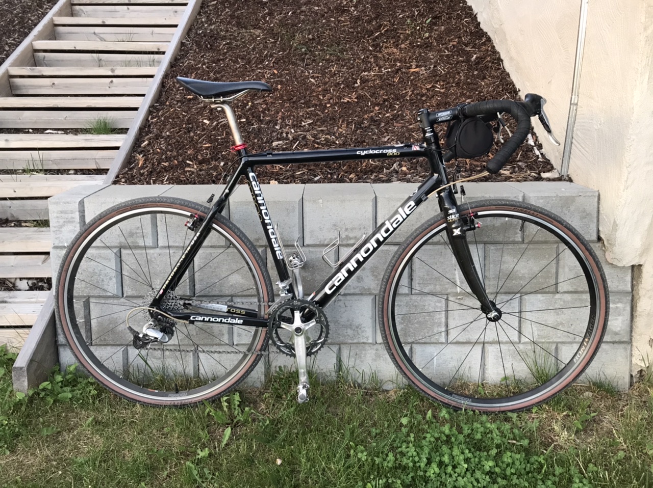

I have now mounted my old crosser With Bontrager Paradigm TLR (internal width 19 mm) with Pirelli Cintaurato Gravel H 35c tires and I think this (as you said above) is pretty close to max, although you might fit 37c... AND secondly it looks really kick ass with the tan sidewalls and dark rims... oh lord. Will post pic later :)
I haven't seen Pirellis here since the days of 20 mm tubulars, still have one of those. I will have to look around and see if they are distributed in the USA. I'm looking forward to seeing your bike.
