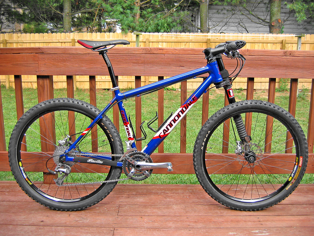

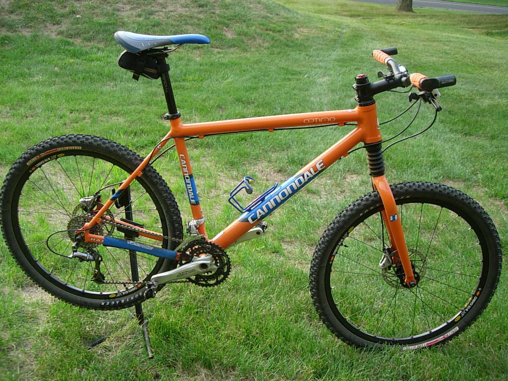

I think it is a 2006 Cannondale F2000 SL. Like it was already mentioned the Optimo frame was used for the top end bikes only. Look at these two photos attached, these are without a doubt F2000 SL from 2006 - the frame design looks exactly the same for me (with a different color).
