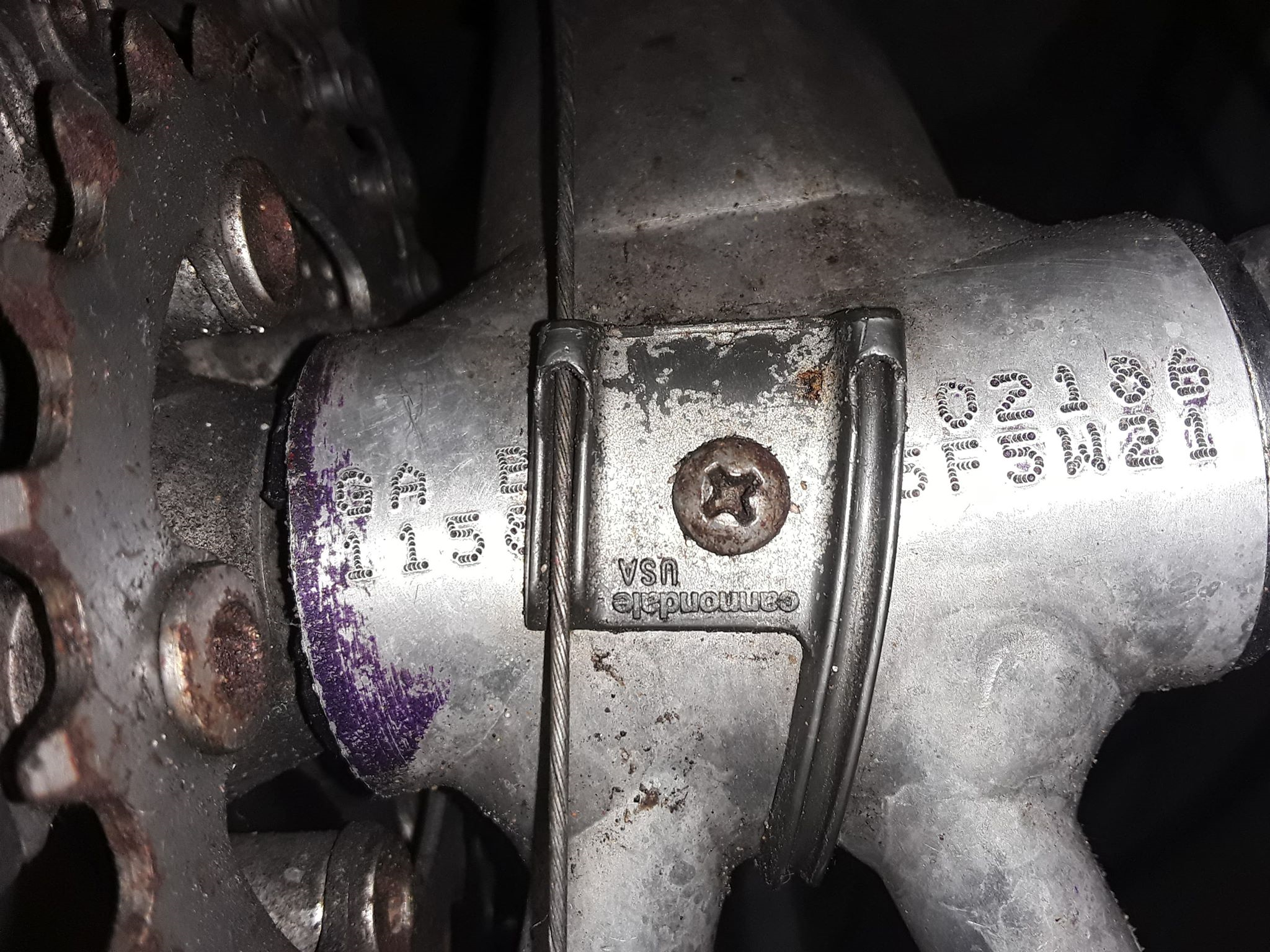

I have an opportunity to own this bike. The frame has been stripped of most of the paint and I am color blind but believe it to be purple(?) from the traces of paint on the BB. Here are the numbers, do I need to take the cable router off to see which frame size and model this frame is?
Thanks!
Can't tell much from the serial number about the specific model. Looks to be a Jan. 1995 build date and a 21" frame. Pretty sure it's a 1995 Killer V 900. The paint was called Diamond Black Metallic with Violet Pearl Hyper-Highlight, but it's basically purple. I have the same bike with level top tube, same color, 1995 M900.
