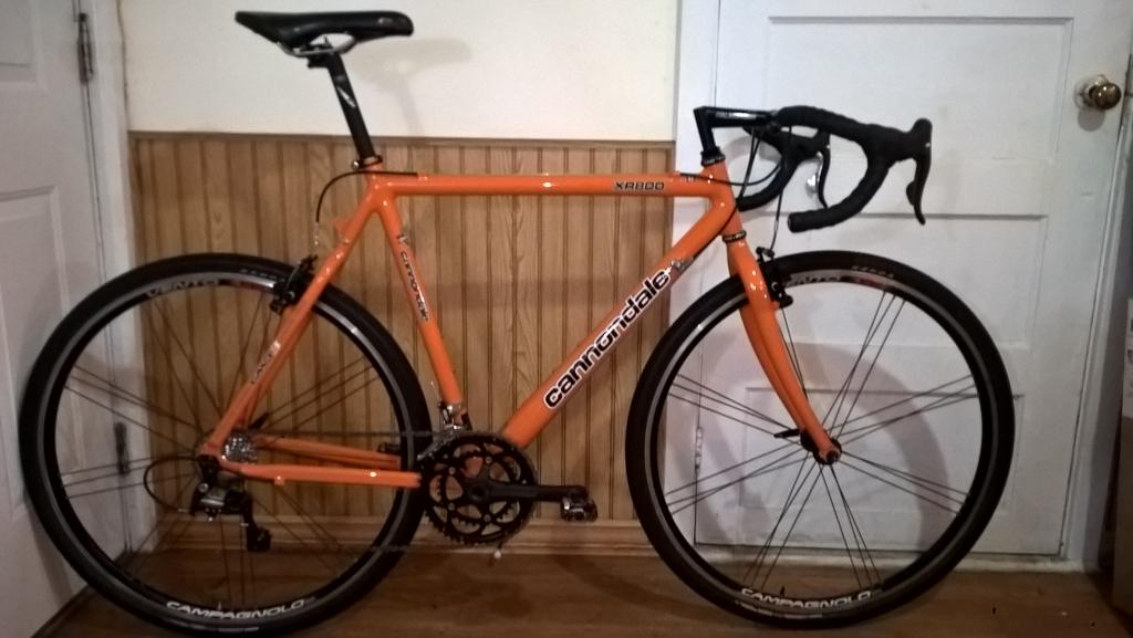

I have two XR800s. My problem with them is that they are "vertically deficient", meaning neither seat or head tube is tall enough for me. I end up way too leaned over even on the largest size (58 cm IIRC). I much prefer the geometry of the Asian made CAADX from circa 2011. Pic is a 56 cm XR800 from around 1998.
Interesting. I’m 6’2” with a 34 inch inseam. I think Cannondale sizing chart says I’m good for 58cm. But I wonder about that. I know on their mtb frames prior to 2010 the XL “feels” like the correct size. Reading your comment I may have to stick to a 60cm in my searching.
