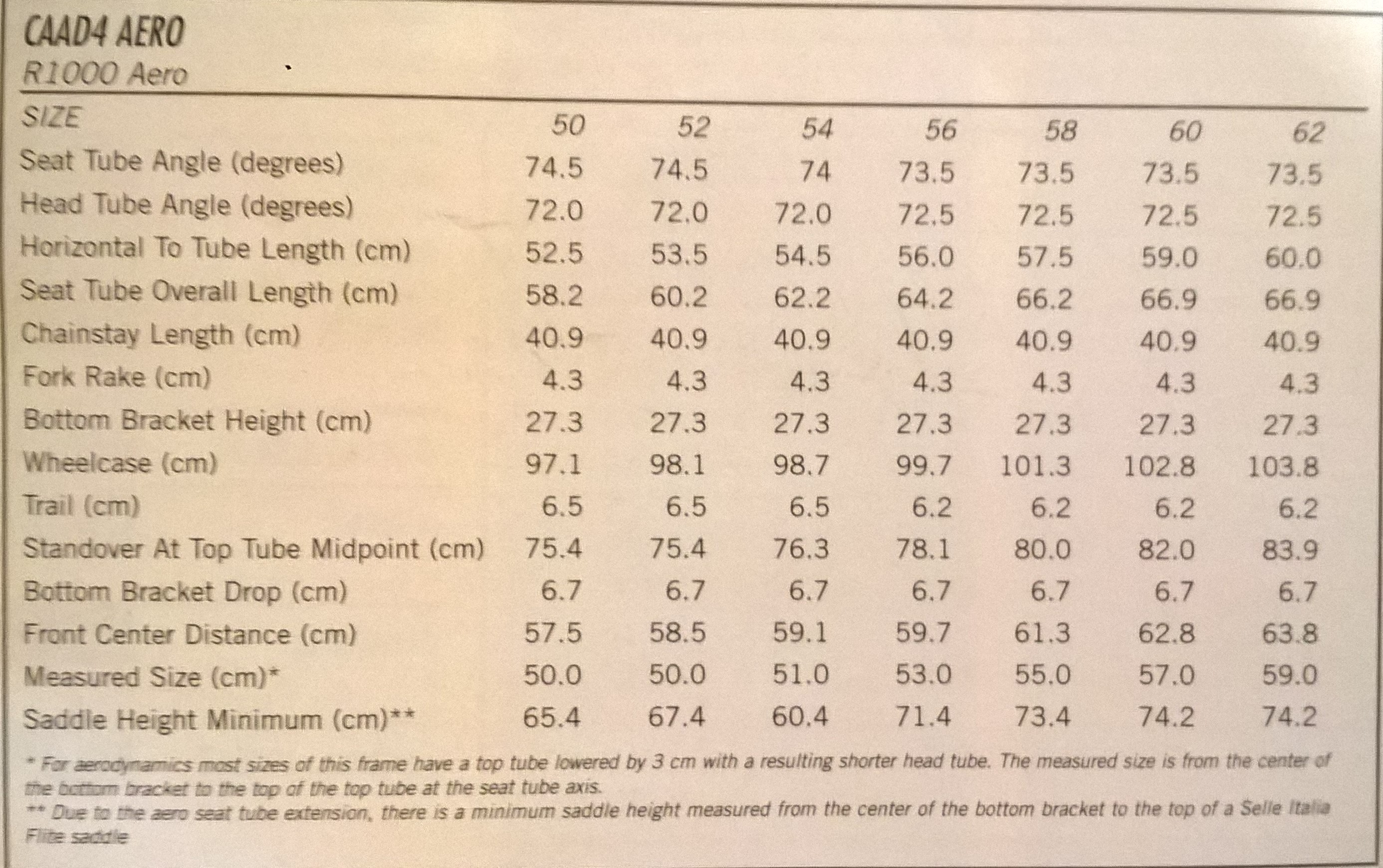

Are you thinking of a bike with 650C or 700C wheel size? Cannondale made time trial frames with both wheel sizes at the time. I don't know what the team used but I'd guess 700C. In 2001 the frame would have been a CAAD4. I don't have a better scan of the 2001 catalog, but I have a print copy of the 2000 catalog. The geometry didn't change from 2000-2001. Here's the 2000 geometry chart for the 700C frames.
FirstTT
Thanks a lot for the upload! Yes, I´m going for the 700c option.
Now it´s time to decide on frame size and sourcing the frame/bike. I try to post a build thread.

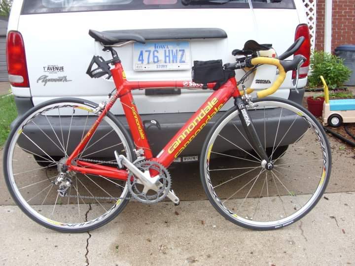

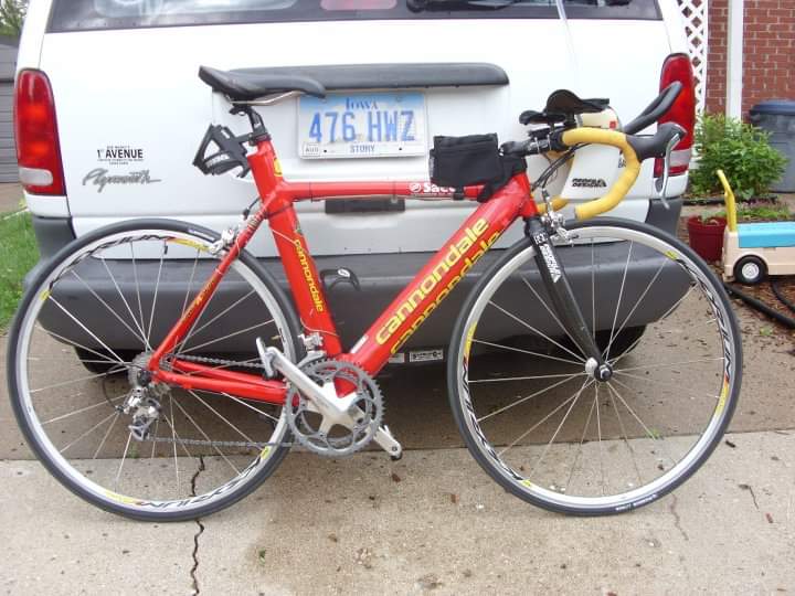

Love these bikes! The CAAD 4 Aero bikes are fast, ride nicely and are reasonably light. Only comment is that the geometry is a bit aggressive overall and the bike itself is very quick handling...not twitch, but darty. It's never gotten the wobbles on really fast downhill sections, but it will really dive hard into a corner - if you are used to riding a modern mountain bike, you'll stuff this bike into the ground on a quick, tight corner if you aren't careful. That being said - I'd give a kidney to find a fork like what is in the top photo, as I've broken mine and replaced with a capable, but much less beautiful Profile ASC fork.

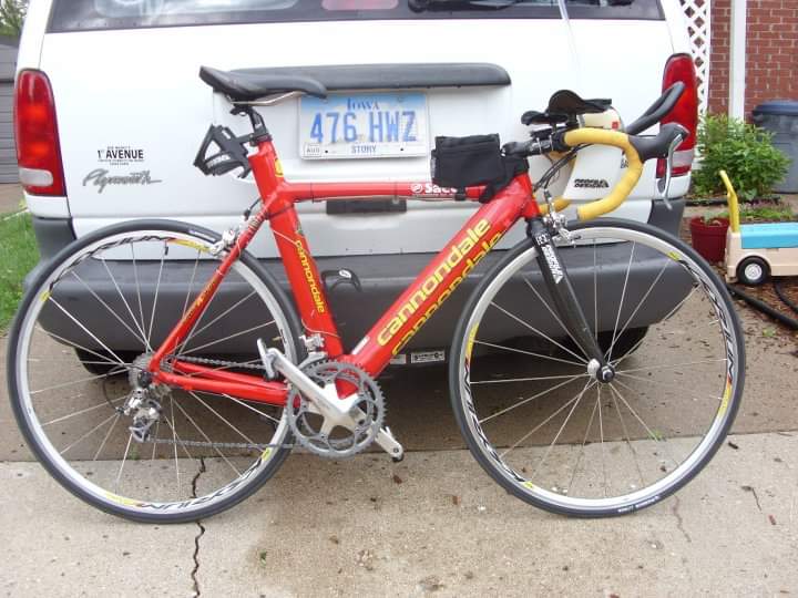

Ten year old pic of the bike with and without aero bars and the with and without the original fork. Man - I don't have that minivan or that house anymore, but I still have the bike!

Such a beautiful bike!

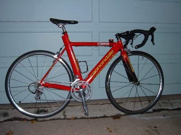

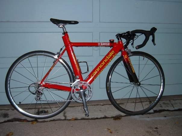

Here is my CAAD4 aero incarnation.
Few upgrades since, tririg frontbrake, 54t aero oval chainring and chopped the steerer.
