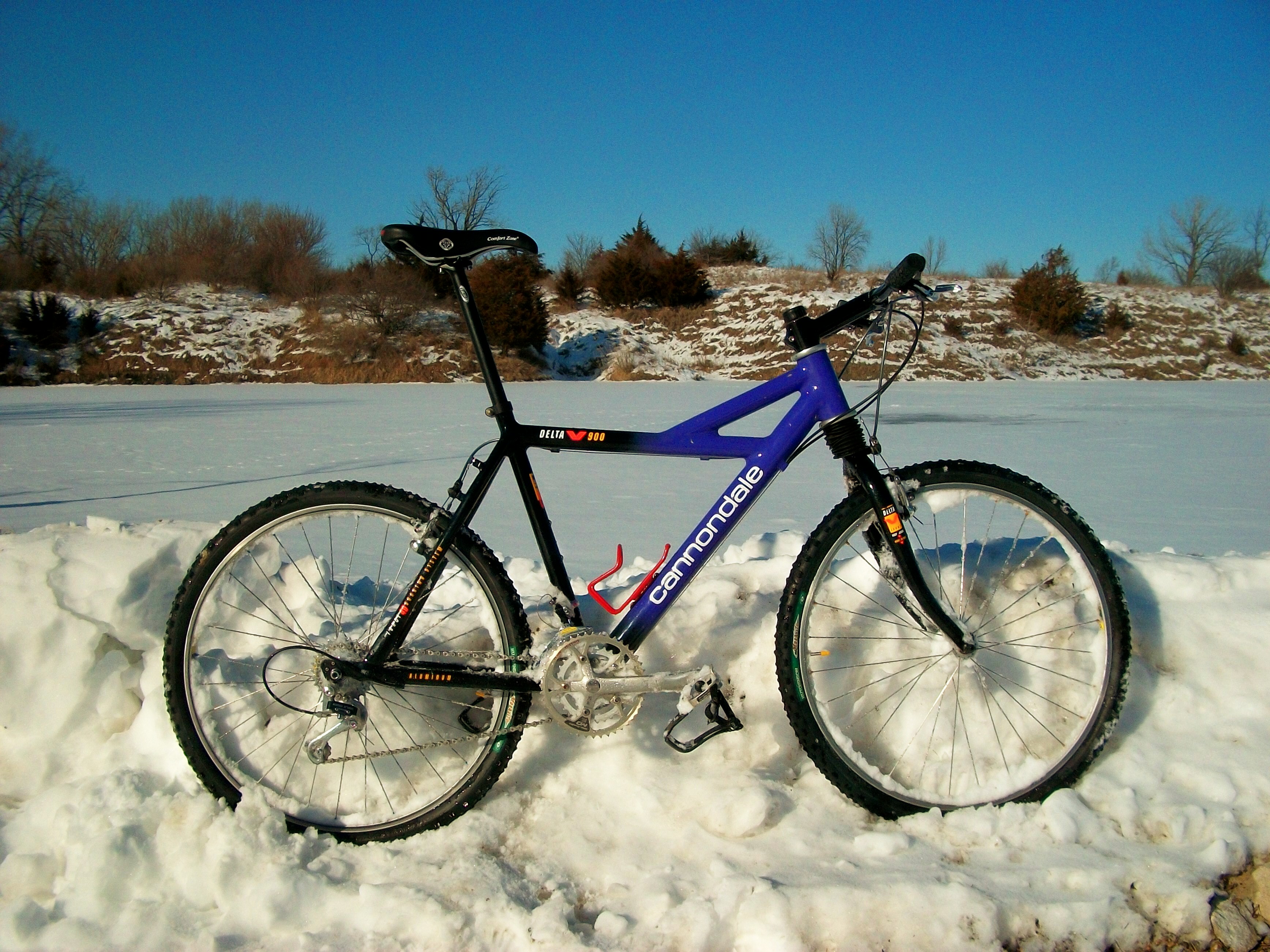

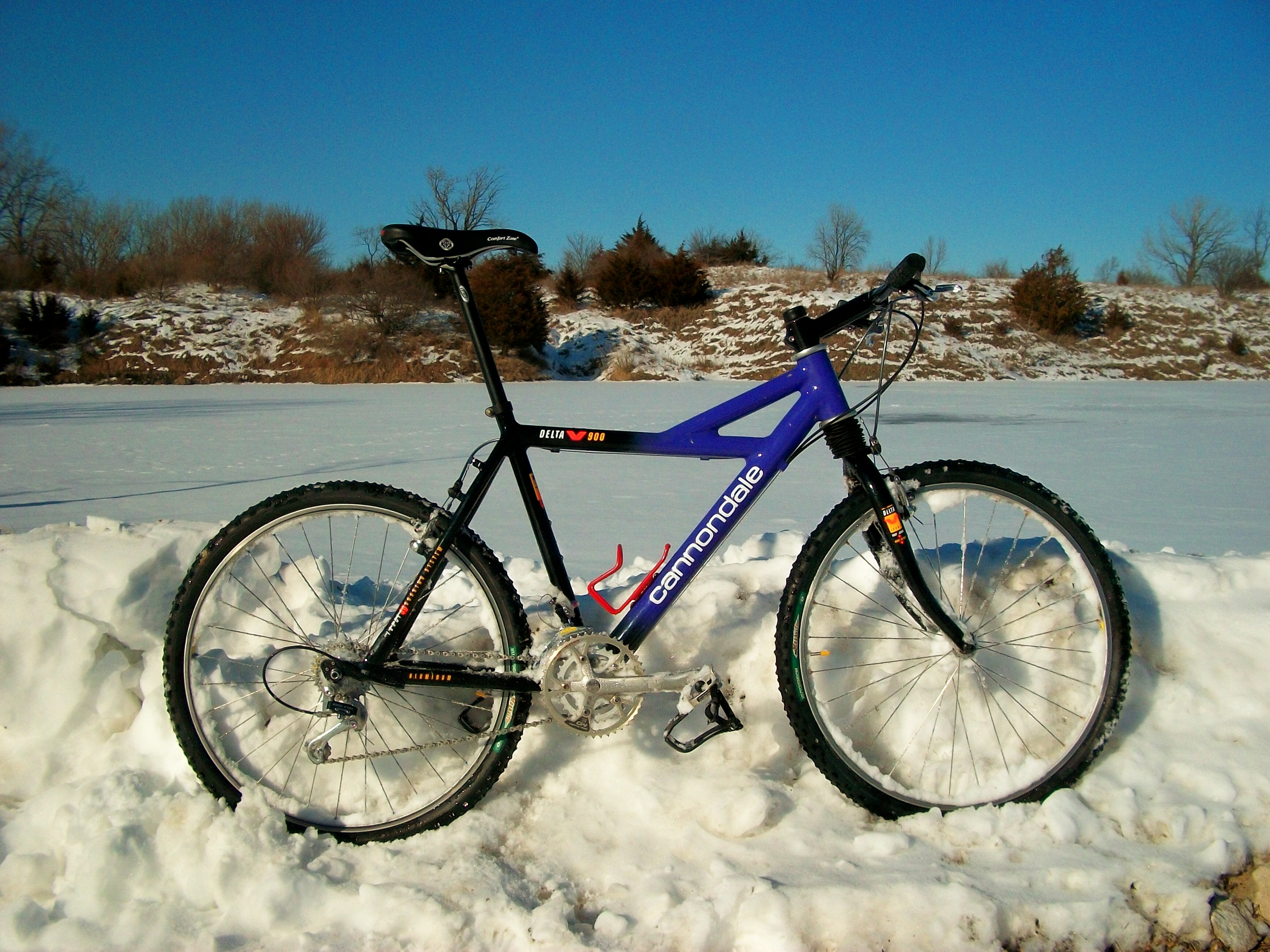

Thanks. I bought a Killer V 900 back in 1994. It was rigid. I'm kicking myself as the store did have a Delta V but it was several hundred dollars more expensive(!). Not that I'm complaining, I loved my KV and I still own it today (24 years!).
Only issue I have with the Fatty upgrade is that they use straight fork blades, so it loses the original look of the Pepperoni blades.
I'll check out that link!
The photo below of my KV900 was taken several years ago. The Spin wheels are long gone (went on another bike which I sold) and although it's been a wall-hanger for a while, I'm bringing it back to life later this summer.

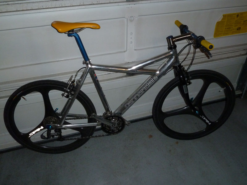

That looks like a '95 KV900. I have the similar spec but level TT M900 in purple. I bought it new, it's all original except for tires, skewers, and rear rack. I need to get a photo some time. Here's my '92 Delta V900. Originally 7 speed LX, I built it with mixed SunTour 8 speed parts. Let us know what you find out about servicing/upgrading the Pepperoni forks.

That looks like a '95 KV900. I have the similar spec but level TT M900 in purple. I bought it new, it's all original except for tires, skewers, and rear rack. I need to get a photo some time. Here's my '92 Delta V900. Originally 7 speed LX, I built it with mixed SunTour 8 speed parts. Let us know what you find out about servicing/upgrading the Pepperoni forks.View attachment 2598
Nice...
The only original parts on my KV900 in that photo is the frame, forks, stem and seat post. I saved all of the original parts though and most of the good stuff that still works, will be put back on during this current rebuild.
