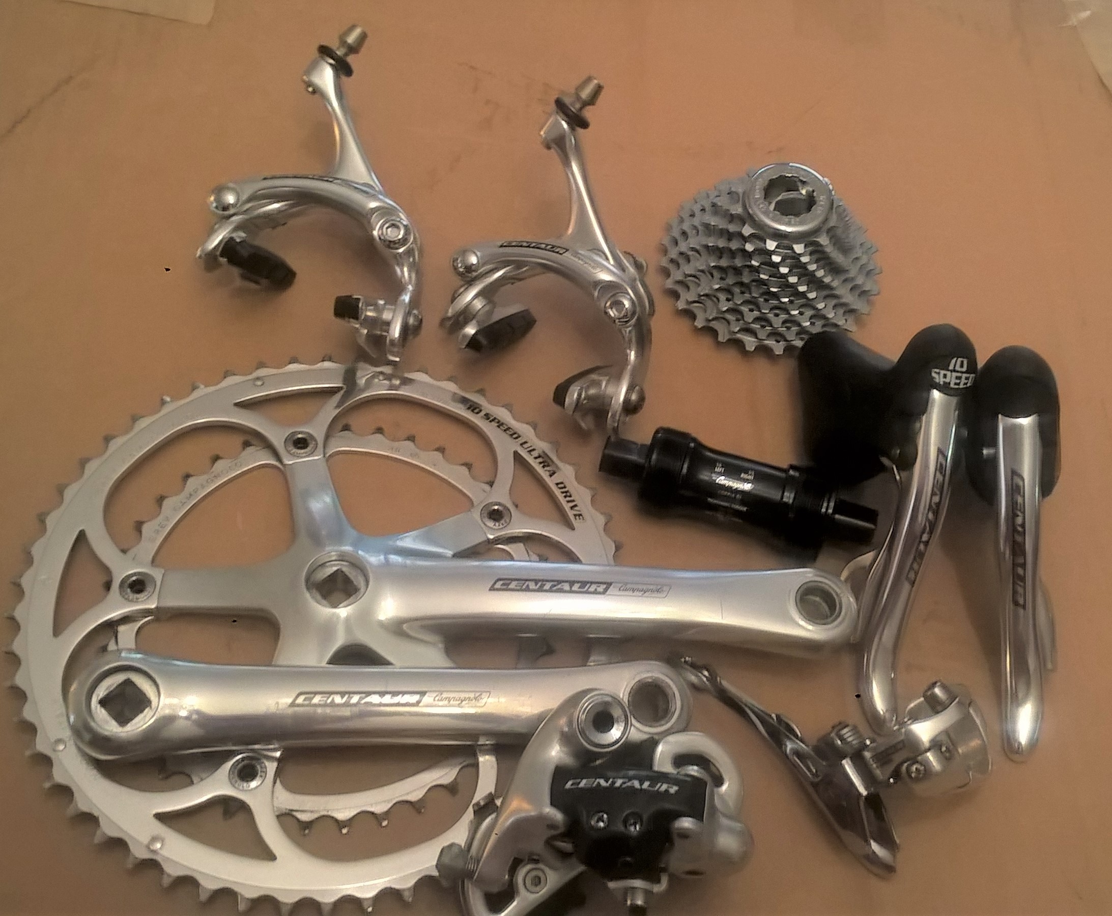

I have lots of Centaur stuff, so just grabbed some that was handy. There are other options for derailleurs, cassettes, cranks. This group is period correct except for the later BB and RD. 172.5 crank, 39/53, new 12-25 cassette. Calipers have one 50 mile ride on them. I will try to remember to bring the scale home from the shop and get a total weight. Also need to sort out how much money I have in the parts.

Thanks so much again! Don't spend too much time on it as i'm still not sure what I really want to do. Do you have any Chrorus or Record 10spd stuff or just Centaur mostly?

I have new Centaur Ultratorque cranks circa 2008. I have a black rear derailleur with the new logo but not sure of the year. Have a new pair of 2009 carbon Centaur Ultrashift levers but it will take big $ to get me to part with them. Cassettes vary with the year, some are all loose cogs (heavier), some have cogs on an AL carrier. The one I posted in the pic has two biggest cogs on a carrier. There may have been earlier or later cassettes with more cogs on carriers. There was also a range of years when Centaur had all steel cogs. I'd guess the weight difference isn't much but the large steel cogs can cut into the freehub body much more than the cogs on carriers do.
