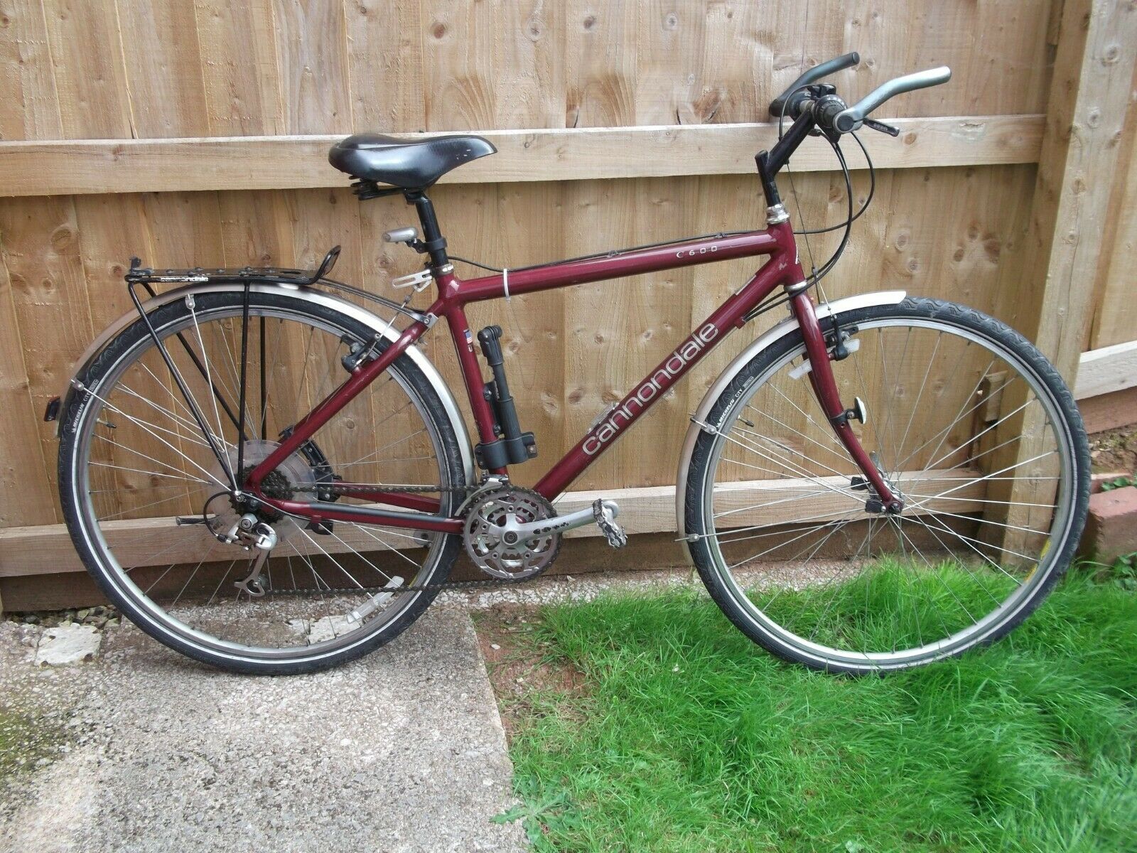

I've attached a picture of the bike itself - and a picture from the 1995 PDF i have.
Threaded steerer - yes.
The seller seems less than inclined to determine the headset size.
When i asked if it had any markings relating to manufacturer or sizes his response was 'don't think so'.....
Thanks again - really appreciate it.

I'm fairly certain that it will be a 1" headset. Cannondale generally used Tange Seiki ME-II headsets on the hybrid models in that era.

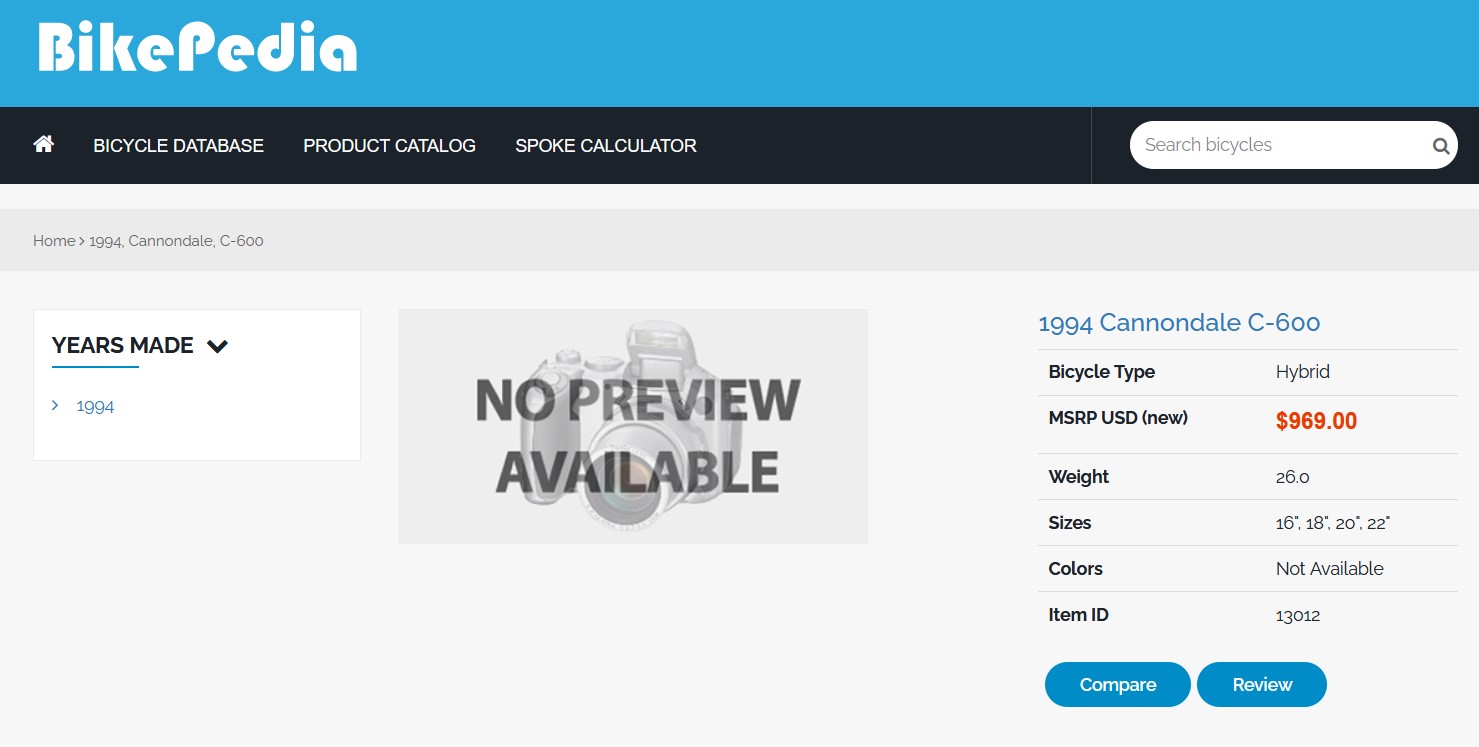

Probably flogging a dead horse here, but.....
I might have been a year out.
According to BikePedia the C600 was only made in 1994.
I suspect that it's one of those things where bikes are released in one year, but considered another year's model.
I saw the C600 in the 1994 USA catalog, but the scan that you posted is clearly in the style of the 1995 catalog rather than the 1994. I haven't checked the catalog scans you linked but I'm guessing that you are looking at a 1995 model.
