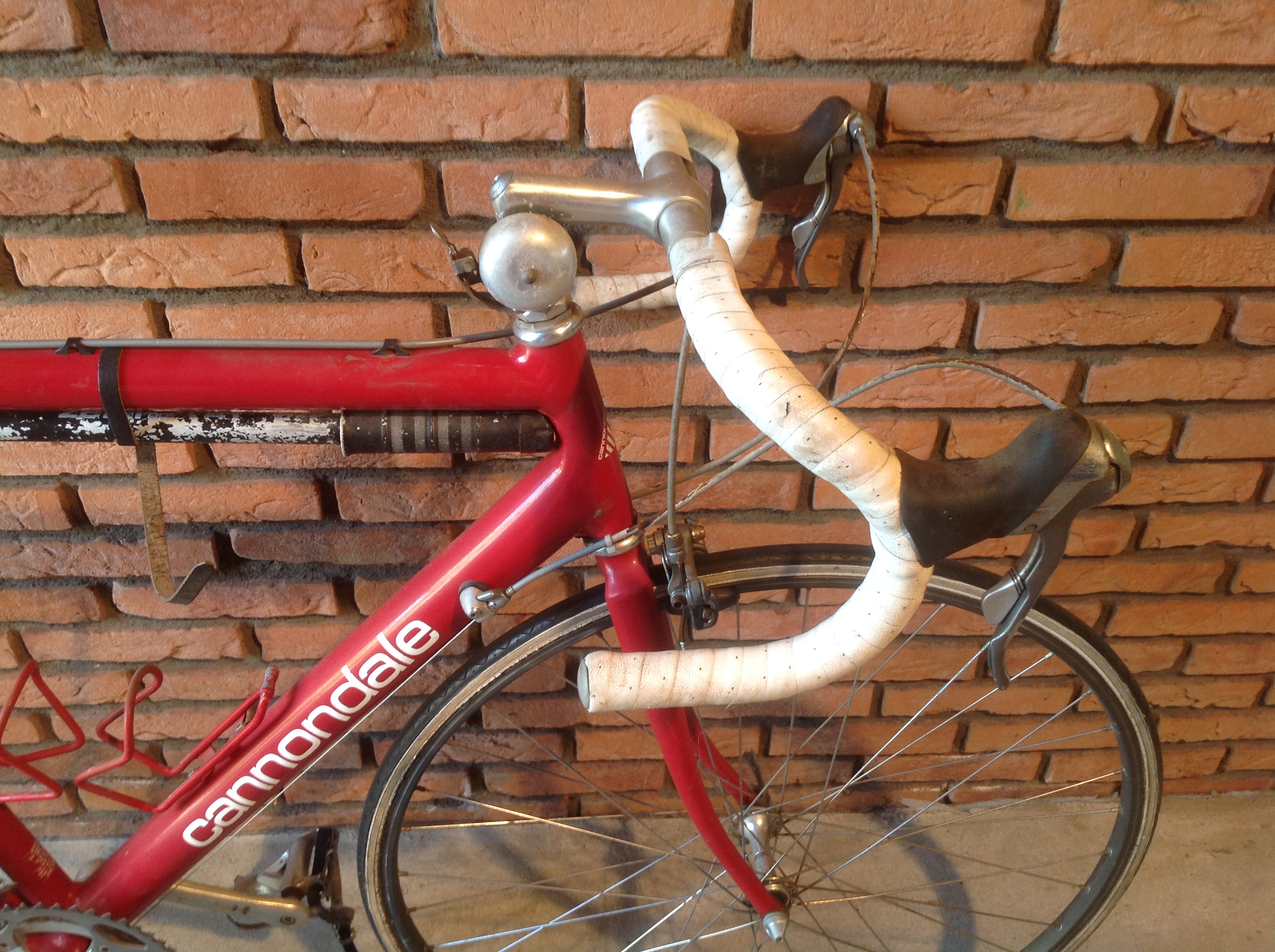

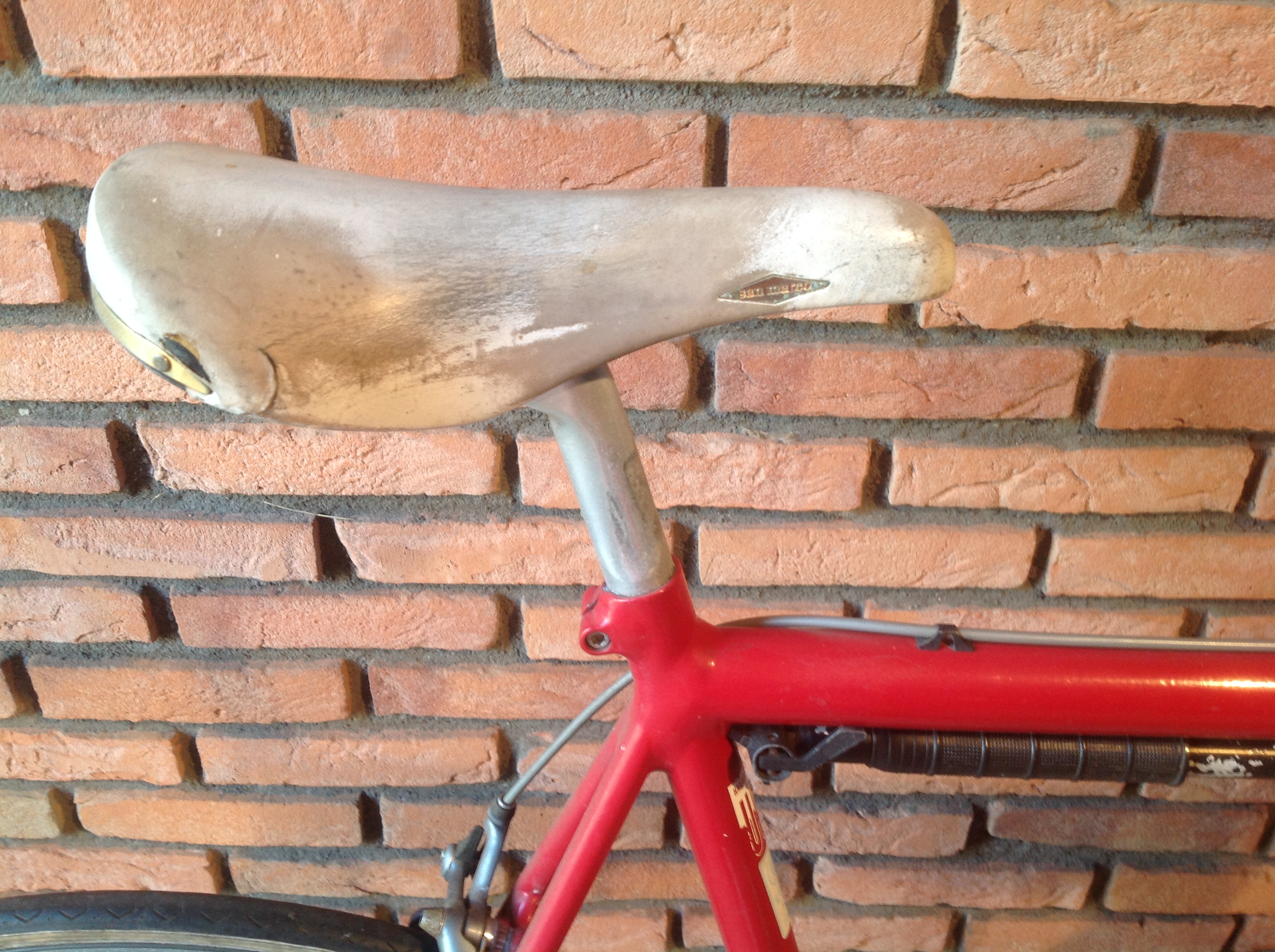

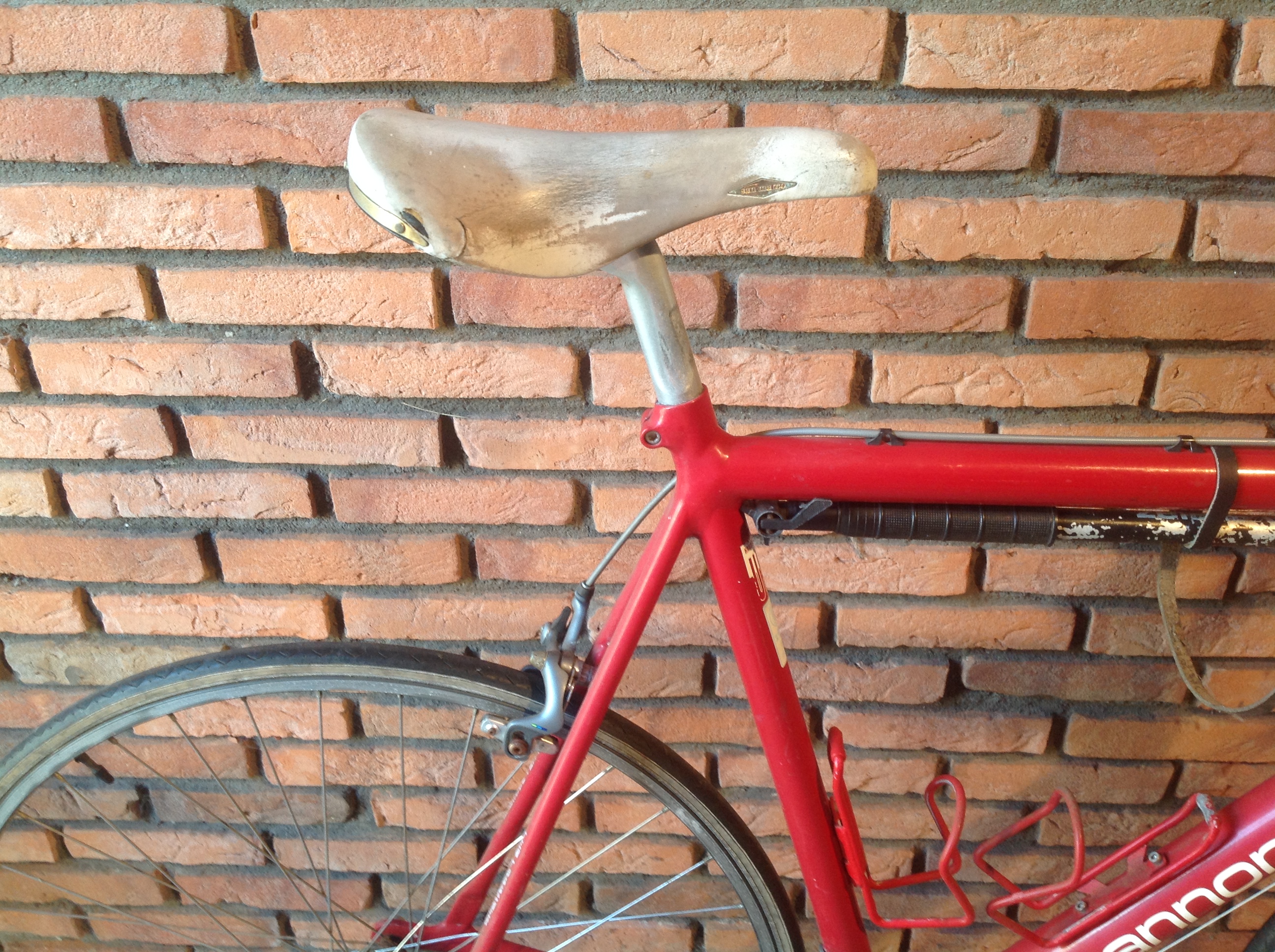

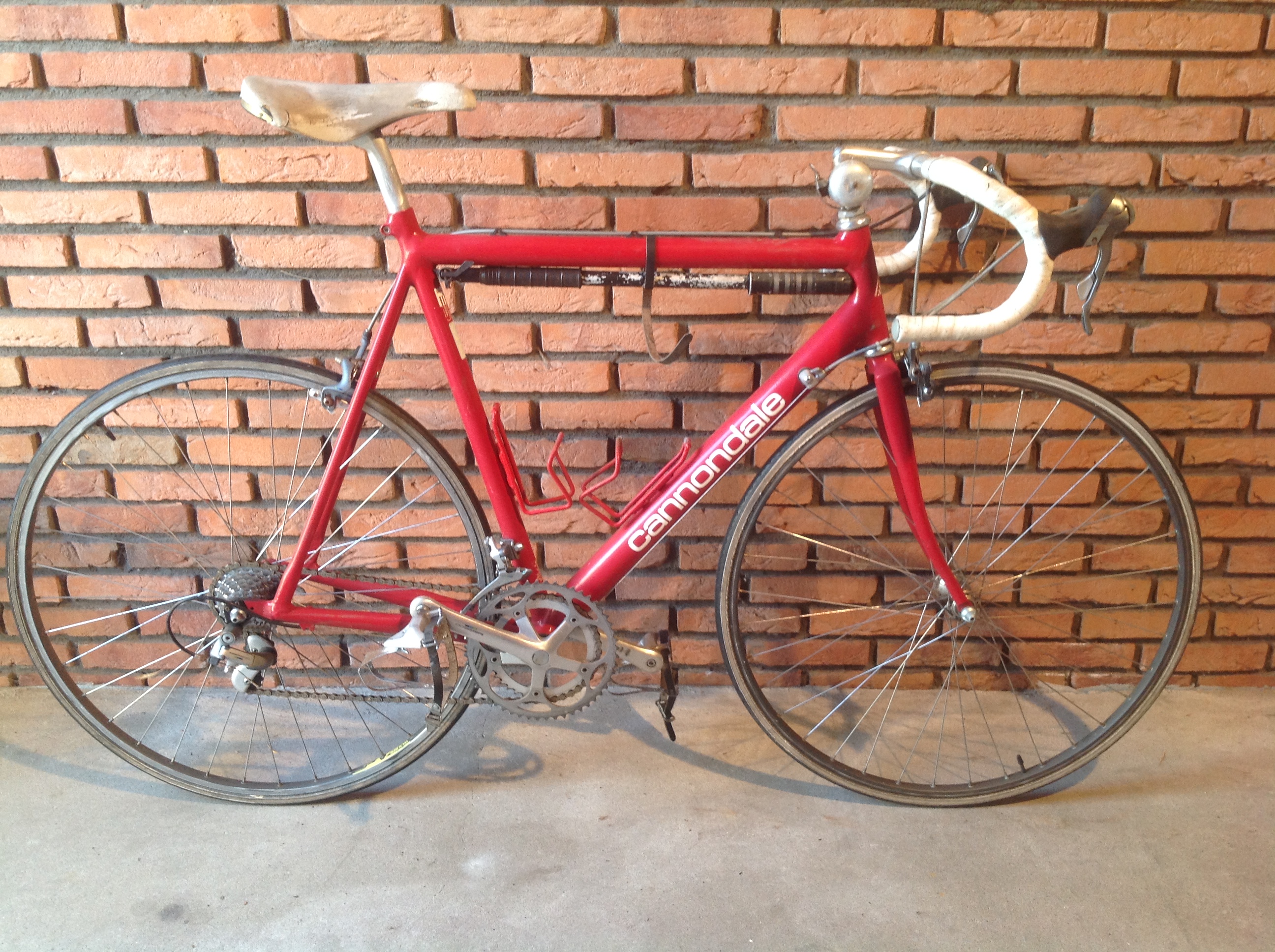

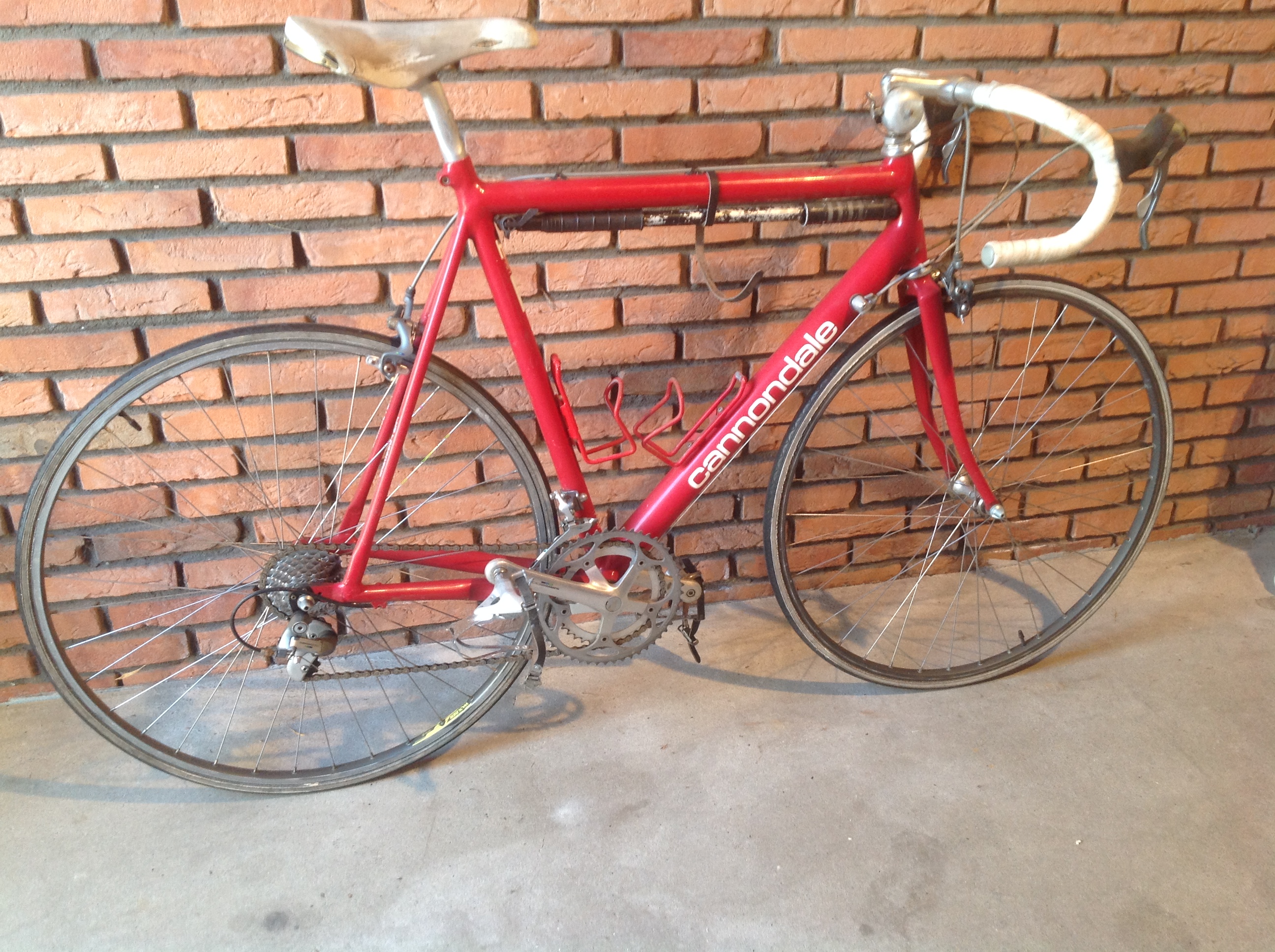

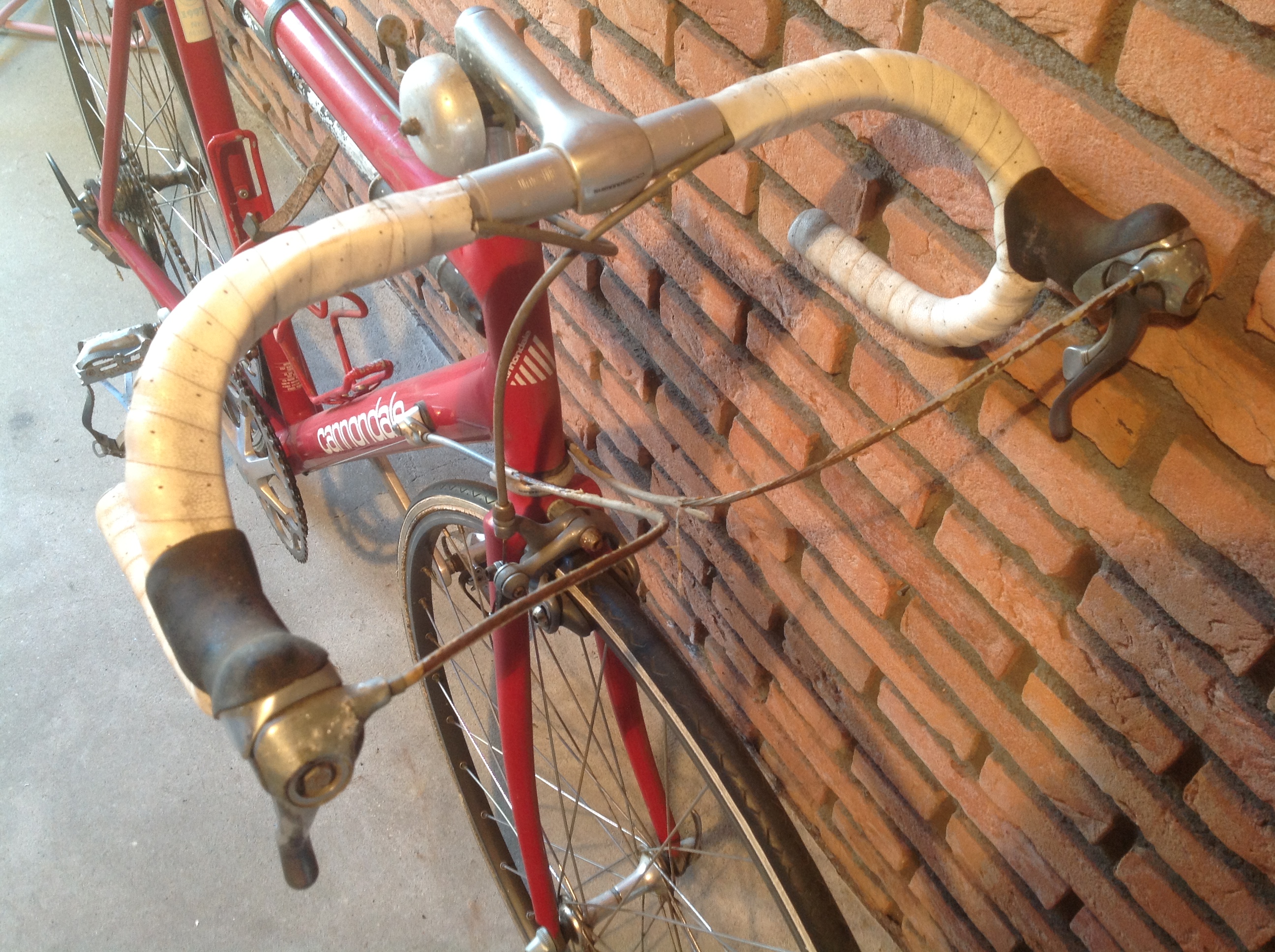

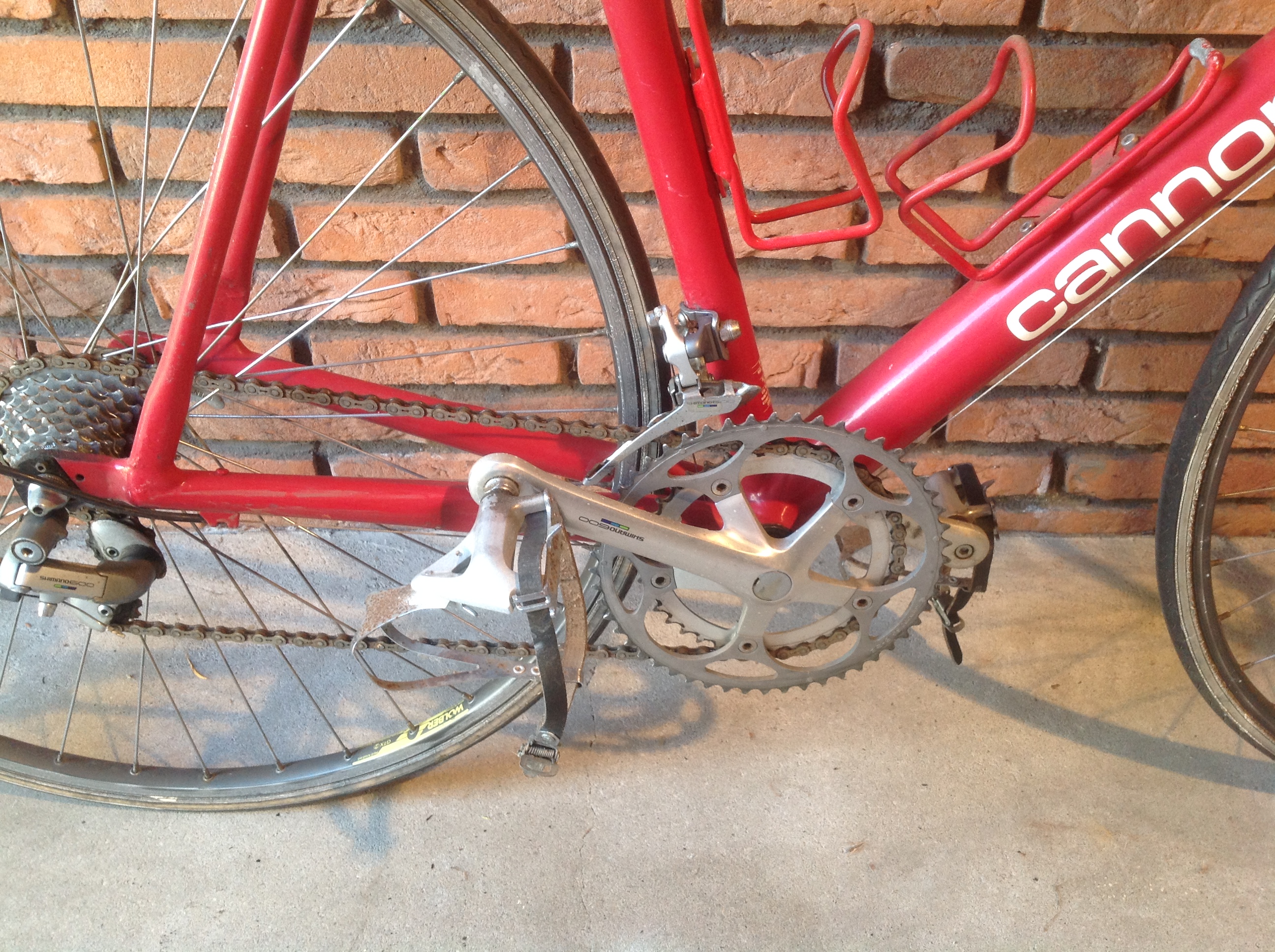

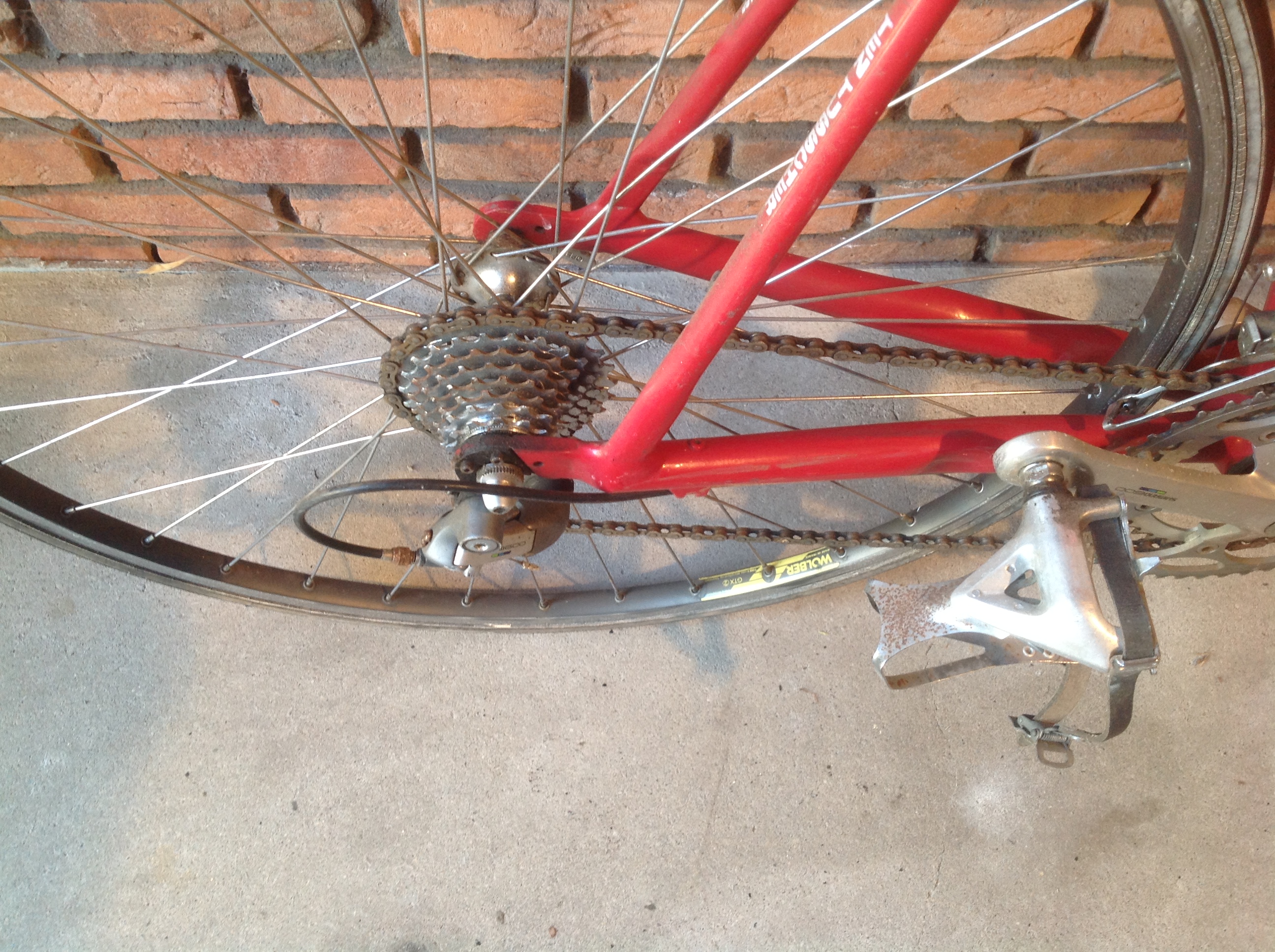

picked this sucker up today
Hung on the wall for 20 years at the first owners place
No dents nice patina and a bit of rust on the shimano parts
Its full shimano 600 tri and also has the shimano Stem and seatpost.
Shifters and cables are gone.
Going to clean and polish the bike and fit 600 shifters on the downtube
Also have some nice nos gumwalls And a flyte sadle lying around
Thougt i share the pictures as found with jou :)
Its in my opinion to good to paint
Any ideas on what to do to it? I,m 90%sure it,s a sr 800 but ........

Interesting bike. You might check the serial number for build date. If you have the "version 2" serial number it will also give you the dropout spacing. In 1991, Ultegra was 7 speed and only down tube shifters were available. In 1992 it changed to 8 speed and STI was available. Your frame is painted more like 1991 than 1992. I agree about the paint, I think a good polishing is all that it needs. Can you tell us what "Ten Tusscher" means?

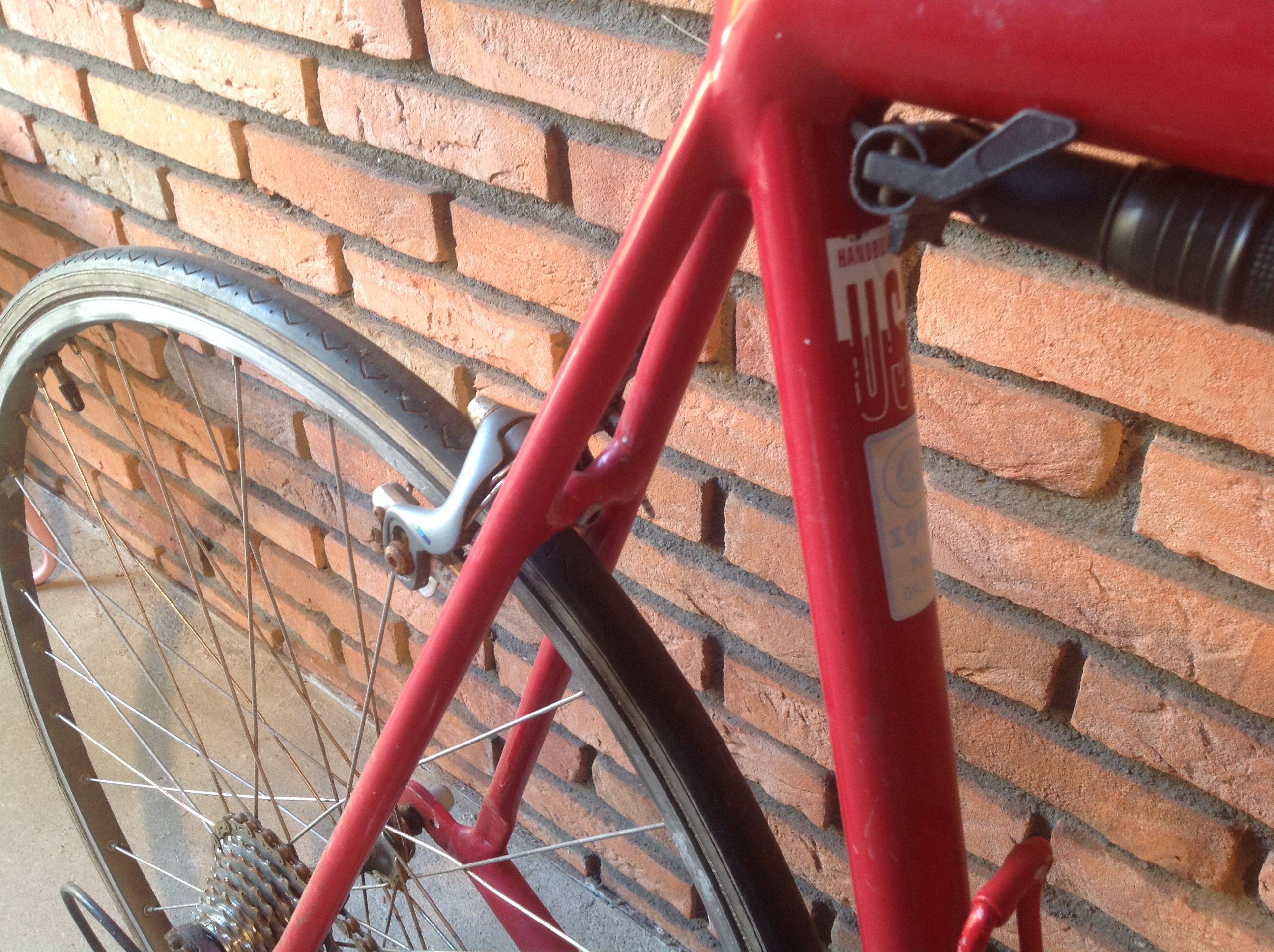

Funny detail: the decal on the seattube is a race number form a bicycle race that took place in sweden in 1997

Always nice to have a bike which has race history. Wish I knew what races some of my bikes were in.

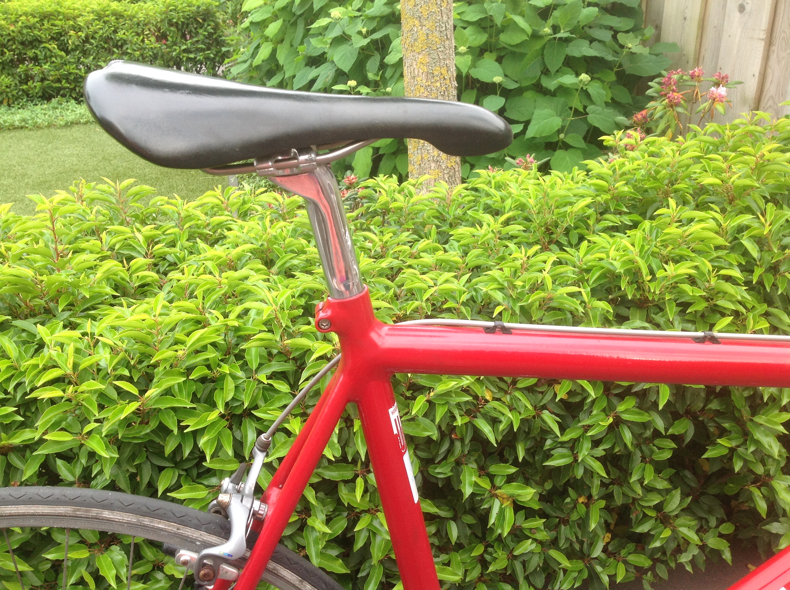

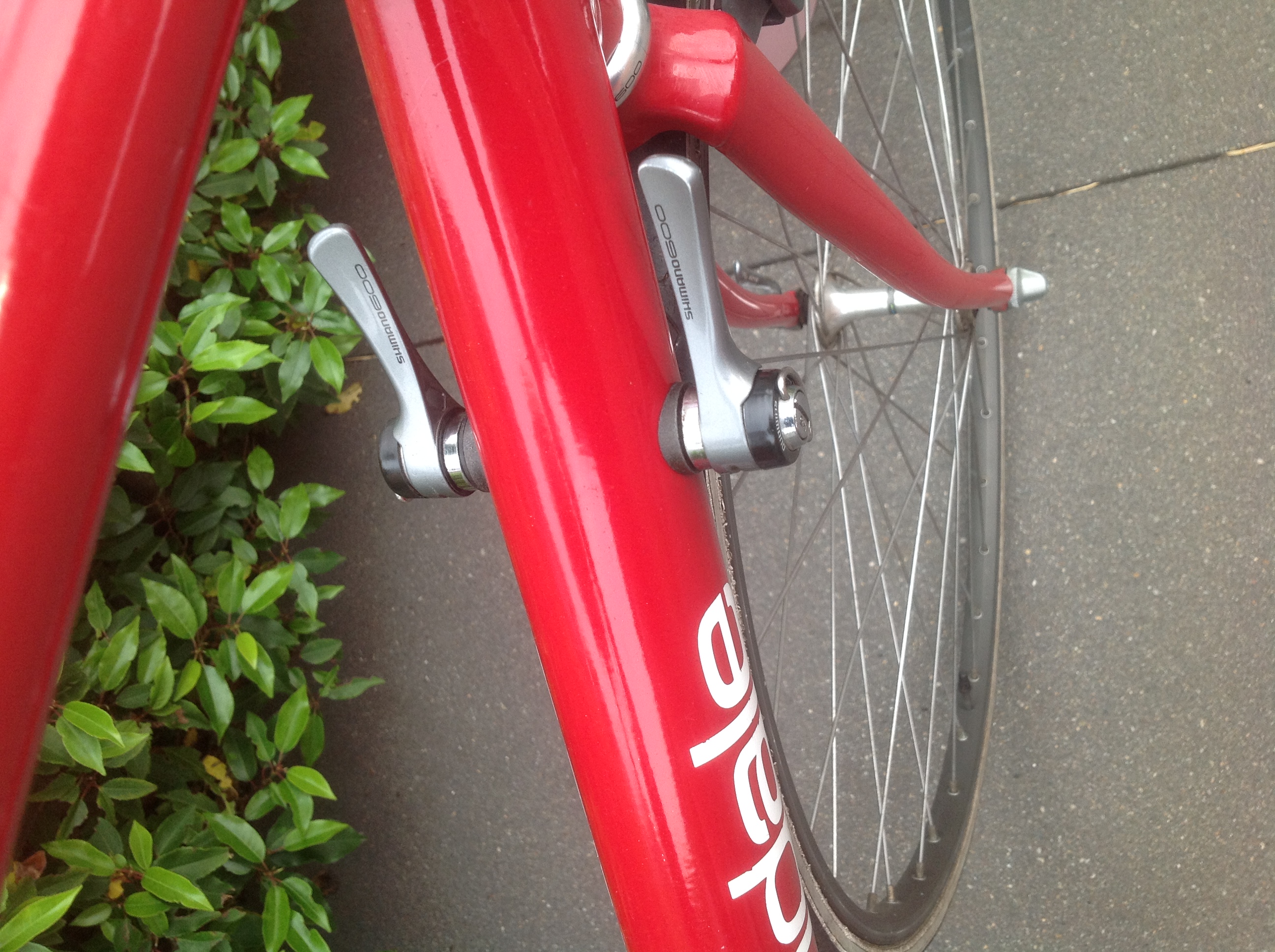

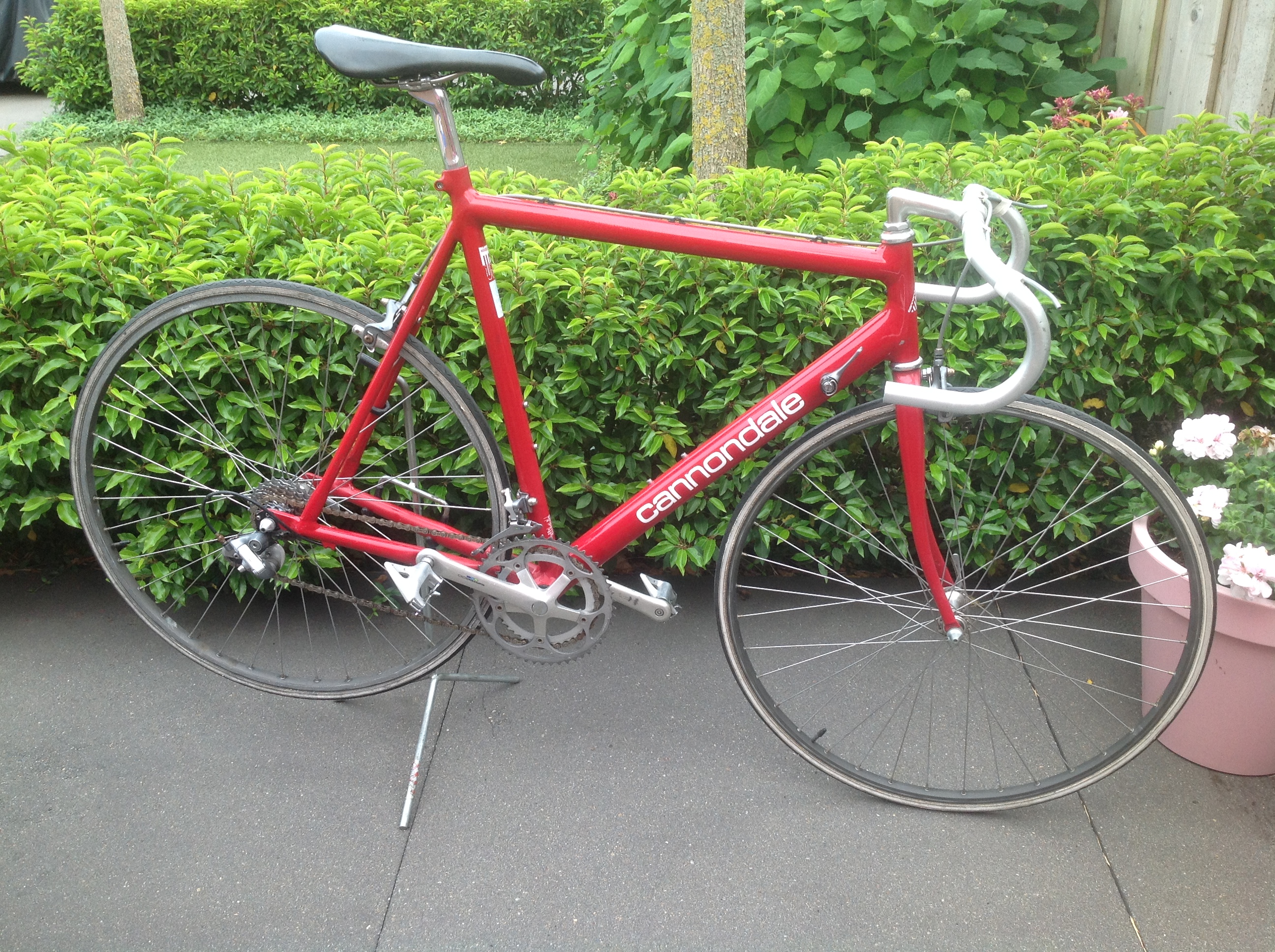

Fitted a flite sadle and tube shifters .....
Going for a nos set dia compe brakelevers in my opinion better looking than the shimano,s
Going for the old skool grey cables
I will check with ten tusscher for the parts when i,m in the neighbourhood

Looking good and very racy with the handlebar so low. Did you find some 8 speed shifters or are you going back to the original 7 speed? My experience is that 7 speed are much easier to find.
MEENI
Going back to 7, had the shifters from another resto. it will be ridable this way on non index but will change it

The 7 speed shifters should index fine on an 8 speed cassette, you just have to give up either the small or large cog.
