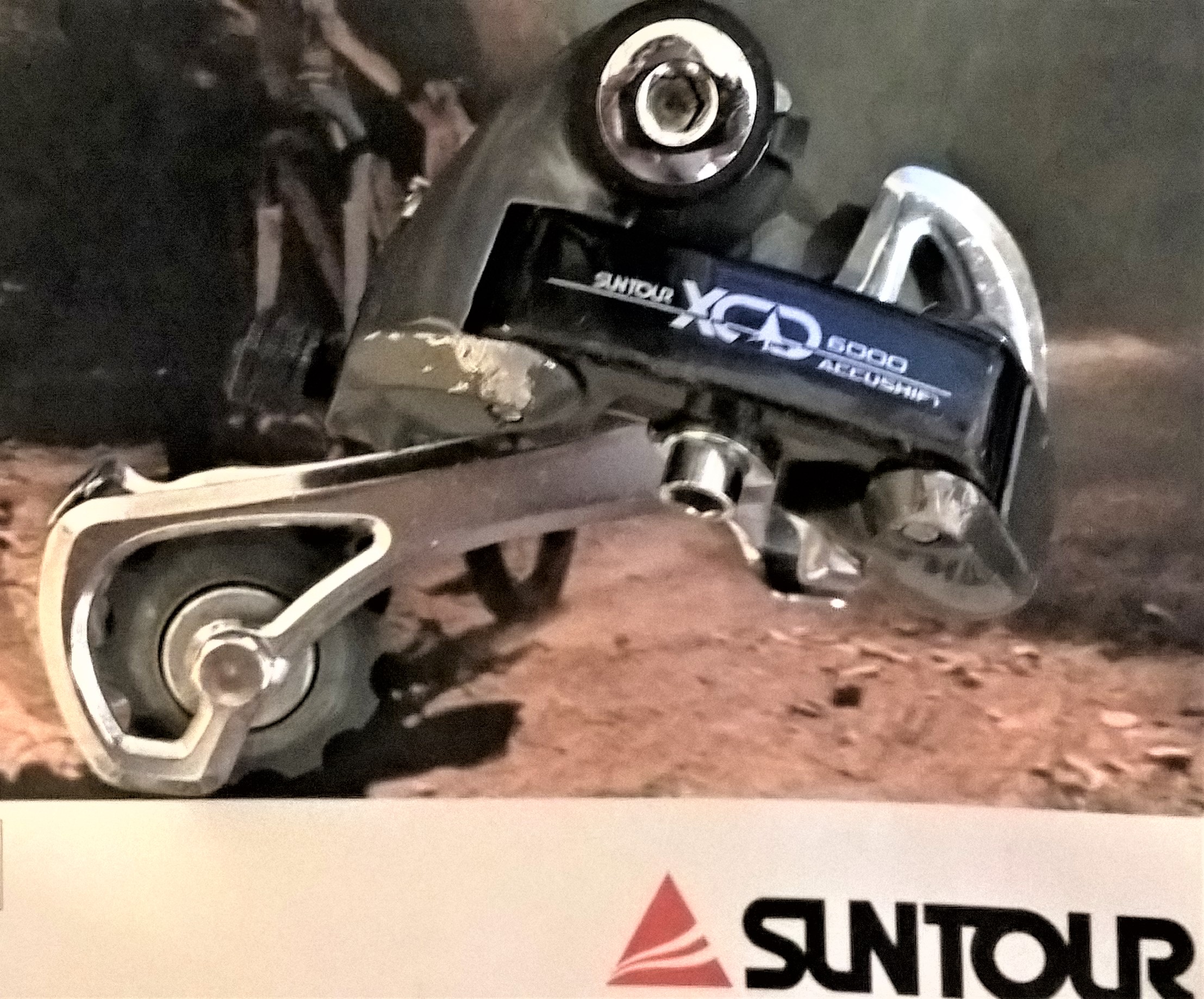

I found a used long cage XCD. Some scuffs in the usual places on a used MTB RD but in good shape other than that. I have a can of touch up paint somewhere that would make this one look fairly presentable.

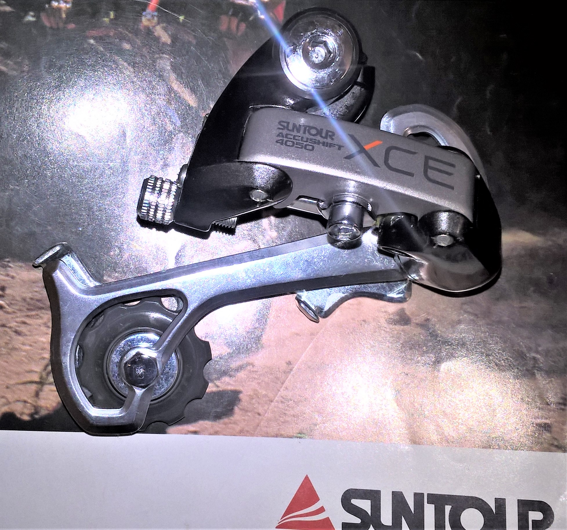

I was mistaken about the long cage 4050. I'd forgotten that in addition to the road group the 4050 designation was also used for XCE. Found a NOS long cage XCE in the SunTour MTB parts box.

Your XCD 6000 is covered in that last document as RD-XD00-GX; by capacities alone it seems compatible. My understanding is that my freewheel is a New Winner, the WP parts in that document are for Winner Pro. The AL part number is for an Alpha, which was a down- market Winner Pro. So I am not 100% sold on the compatibility with my freewheel.
That XCE 4050 is in fact basically a 4050 Long cage. It does appear to be a seven speed; Using that I assume I would need to go to a 7-speed freewheel. Not hard. Just more expense. The Suntour freewheels seem to fetch pretty high prices on eBay - or at least they are priced high.
